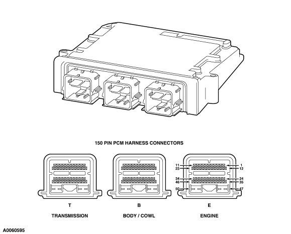

Need PCM pin out
BOBBA LOUIE
  • 2004 FORD EXPLORER
  • 4.0L
  • 4WD
  • 135,000 MILES

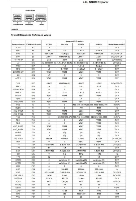

I have and AllDataDIY. Com account, but the PCM pin out seems to be generic. I need the specific Pin out for this vehicle. It has several issues that point to the PCM connections, or a bad PCM.
Would much appreciate your help. This is a three connector unit. The vehicle has a VIN - K for Flex Fuel.
the car/truck either has a PATS or PCM issue.
Thanks in advance,
Bob Lewis
Pisek, ND

This work for you from "Prodemand"?
Diagram below.
The Medic

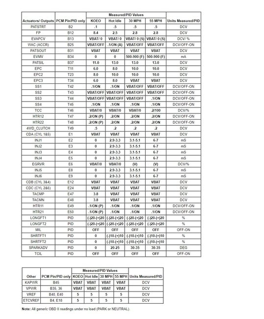

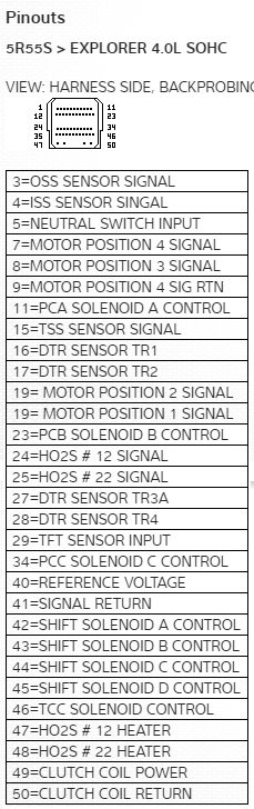

Here are some more values from Ford.
