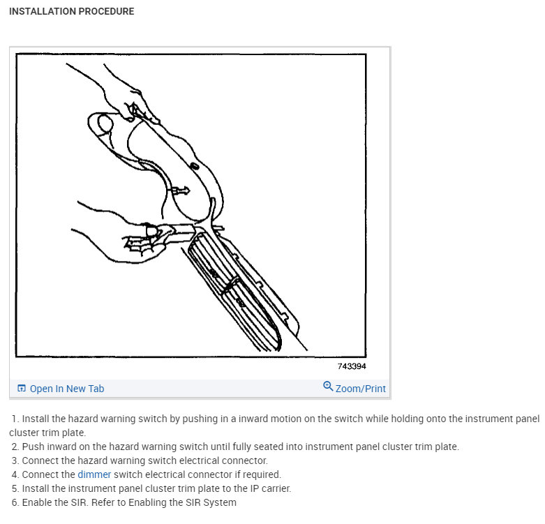

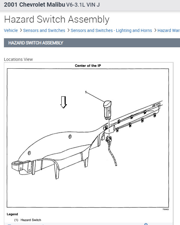

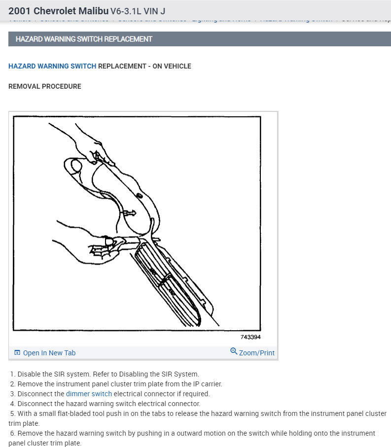

The signal lights and flashers have just stopped working unexpectedly. I have Google and can't seem to find it. Can you tell me where exactly it is located or what else it could be? I have checked the fuses.

The flasher relay is integrated with the hazard switch on the dash.
So, replacement of the hazard switch is necessary to fix the flasher issue.
I have attached diagrams below for your reference.
Let me know of any questions.
