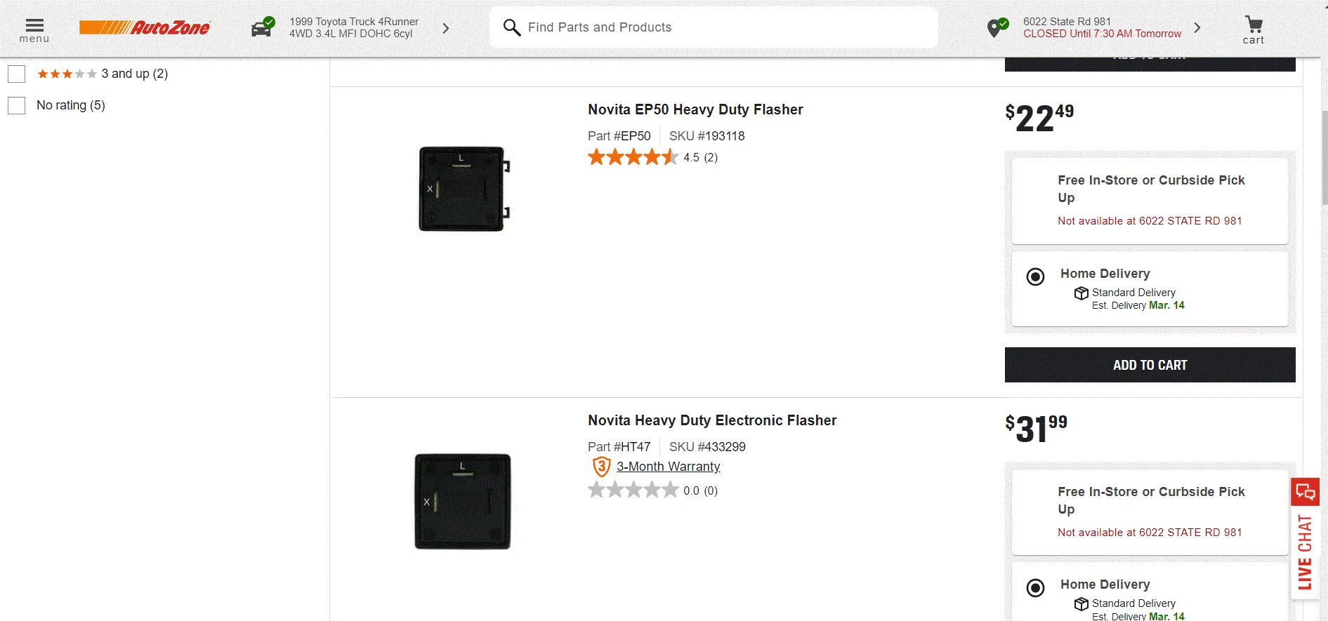

Where can I buy a heavy duty flasher?
1999 TOYOTA 4RUNNER
136,000 MILES • TURBO • 4WD • AUTOMATIC
CRDELPHA
Hooked trailer up to runner, no lights, installed new trailer wiring harness, plugged in. Still no brake or direction lights and now driver side rear reverse light won't work. Was told to get a heavy-duty flasher but can't seem to get one. Even Toyota dealer said he could not get. Please help!!

Where have you checked for one? I found several on the AutoZone website. See pic below.
As far as the issue, you can try a HD flasher, but I question if that will fix it. You should be getting something from the brake and signal lights. Have you checked for power to the light sockets?
Are the parking lights working? If you disconnect the trailer, do the vehicle's lights work properly?
See pic below.

AutoZone does not carry the HD only standard. We have vehicle turn and brake lights, but driver side rear reverse light does not work since putting the new trailer light pkg on. When hooked to a trailer the turn signal lights will work but that's all. Have also checked that there is juice going to all sockets.

I'm surprised AutoZone doesn't sell them. That was their website I sent. Now, when you connect to the trailer and only the signals work, either you have it wired wrong, or something is disconnected.
