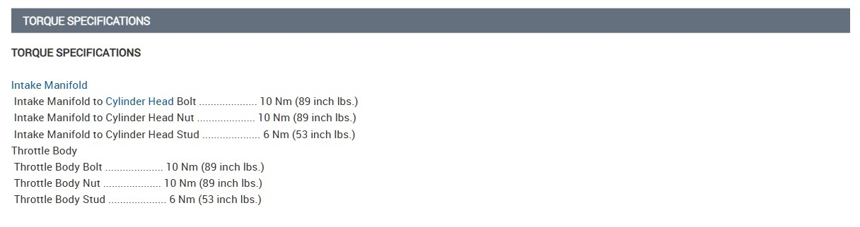

need a diagram of the Intake manifold torque specs and timing chain torque specs?
2005 CHEVROLET CLASSIC
155,000 MILES • 2.2L • 4 CYL • 2WD • AUTOMATIC
TREVISM93

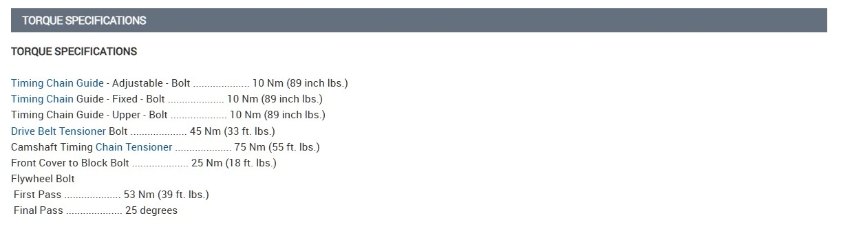

In the middle of changing the timing chain and I don't know what to torque my bolts to when I put it all back together.
Apr 18, 2025 at 8:35 PM
AL514
  • 5,541 POSTS
Hello, do you need diagrams of these components as well? I've found the torque specs already for the intake and throttle body, as well as the timing components, but just let us know if you want any additional diagrams.

Here are the intake manifold and timing components torque specs.

You're just doing the timing chain, not the balance shaft drive chain as well? This looks pretty complicated when doing the complete timing set, there's 37 pages of service info on it.
