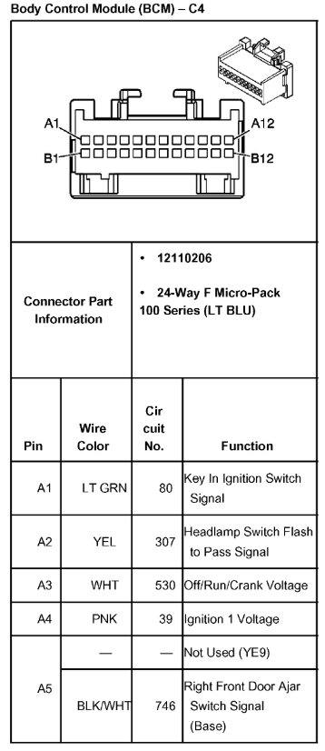

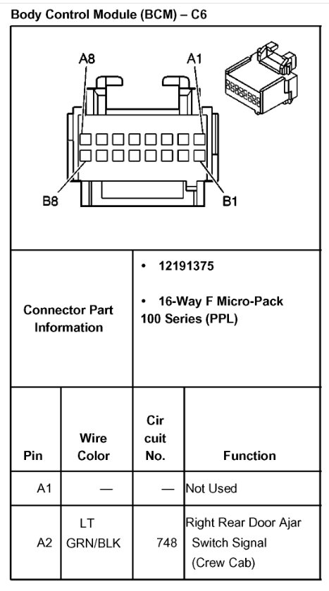

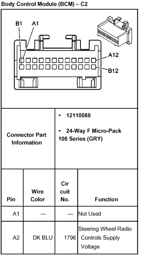

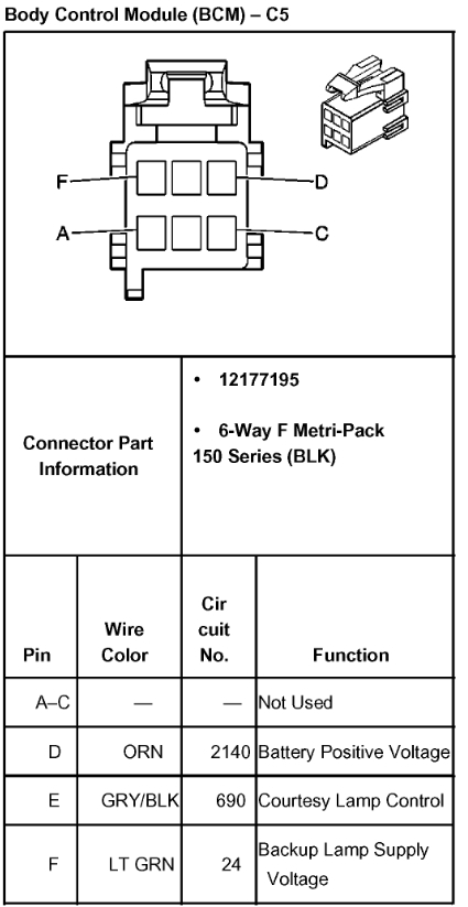

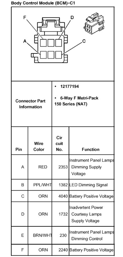

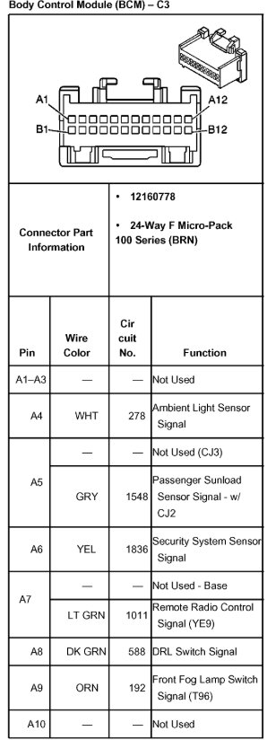

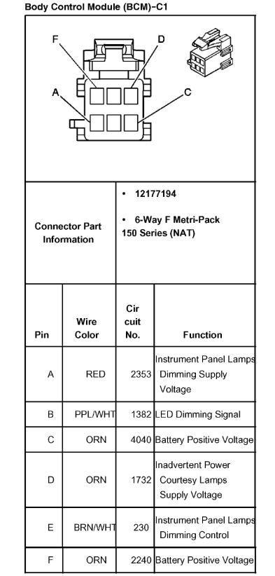

I need the pin out to male a cluster calibration.

Sure, here are the pinouts for the BCM. Check out the images (below). Let us know if you need anything else.
Images (Click to make bigger)
