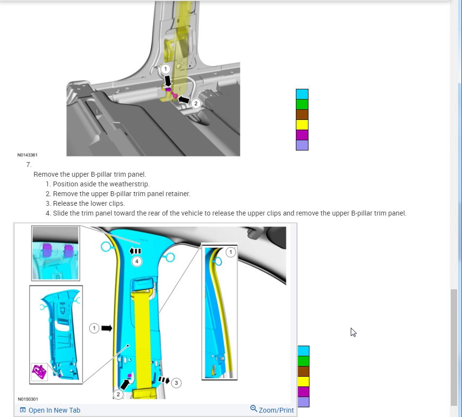

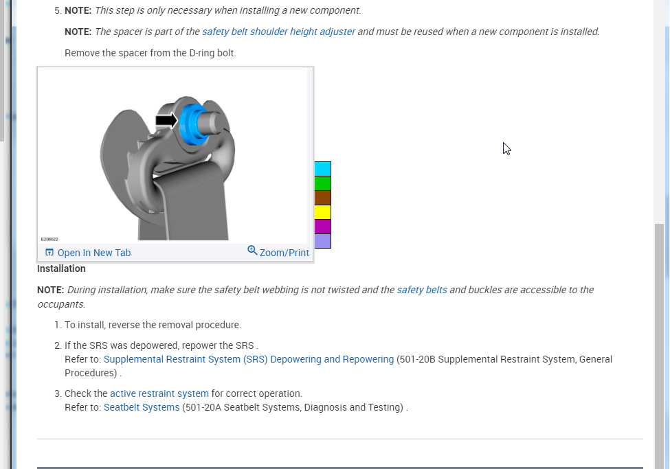

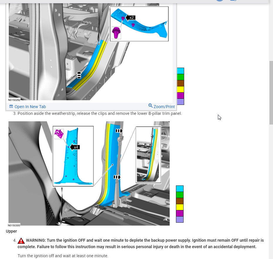

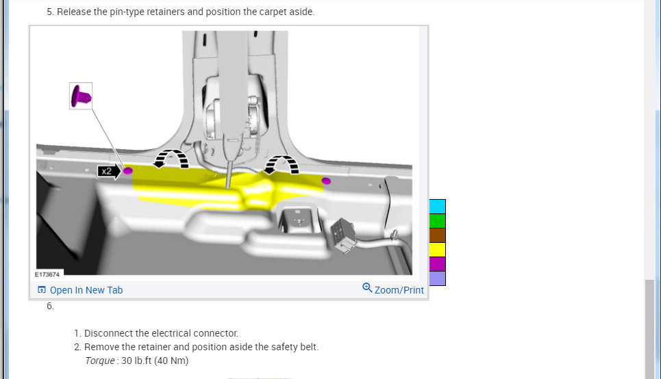

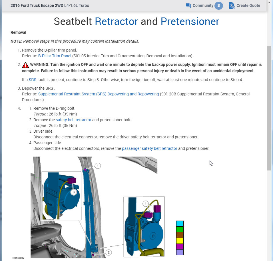

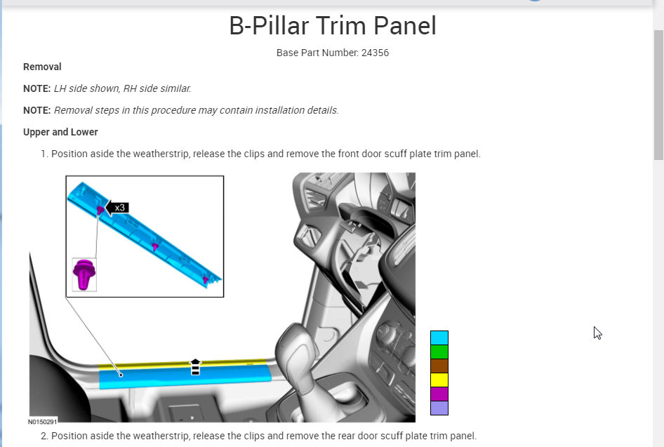

How do I take off the plastic cover on the seat belt retractor?
Monday, March 2nd, 2020 AT 7:30 AM
MECHANIC
18,907 POSTS
I attached the process for removing the retractor. I assume you are referring to the trim pieces over the retractor.
Let me know if this was not what you are looking for. Thanks
Images (Click to make bigger)
