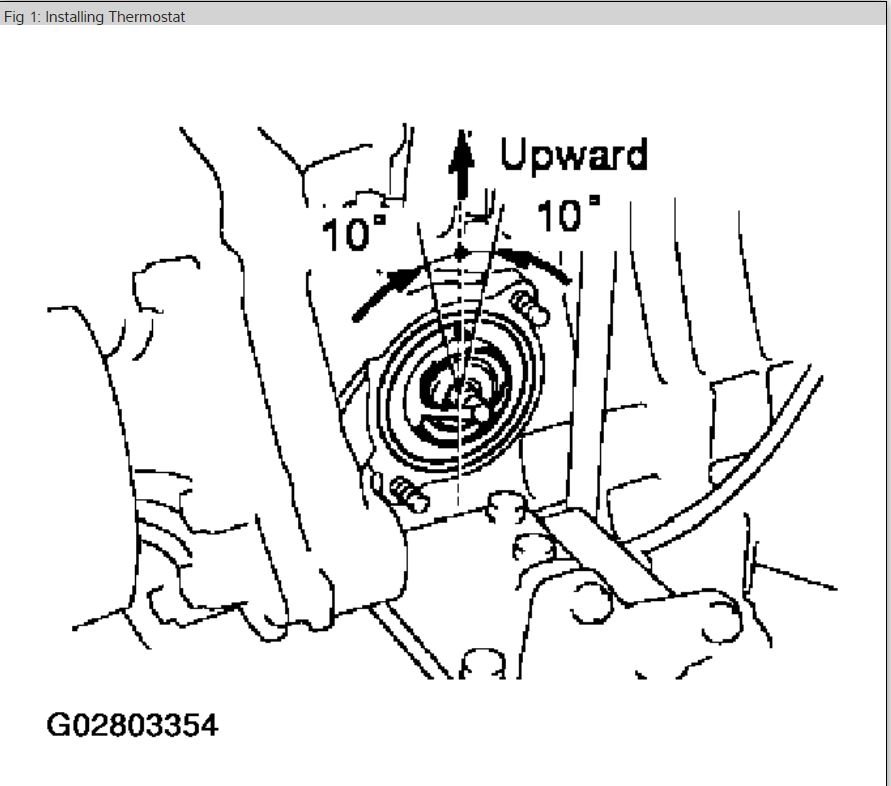

I did a full bleed on my cooling system. Heat is in full blast and the most that is opened allowing coolant to go through the system. At first there was heat coming out of the vent (note) this is during the bleeding process. But when I took the car for test drive the heater stop working and there is no heat coming out of my vent. The temperature gauge pointed to high, but when I turn on to AC while I am driving the temperature gauged goes back to some what to normal. I did a pressure cooling system test and not leaks indication. I also did a combustion leak test and shows no leaks as well. It seems to me that the thermostat stop working while I am driving the vehicle because when I park back the vehicle the lower hose where the thermostat is not hot anymore but the other hose is very hot. I did pull out the thermostat the day before and test it by soaking it into a boiling water. Thermostat started to open and when I pour cold water it stared to close again. I cannot seem to figure out. Please help. Thanks
May 21, 2018 at 5:33 AM
PATENTED_REPAIR_PRO
  • CAR REPAIR CONTRIBUTOR
  • 1,853 POSTS
Make sure the jiggle valve was set within 10° of either side of the twelve o'clock position, like shown here.
May 21, 2018 at 10:08 AM
SEBASTIAN_PERSONAL
  • 77 POSTS
I just checked the position of the thermostat and it is exactly where it needs to be. Any other ideas that might help me diagnose the ptoblem? Thanks
May 21, 2018 at 10:47 AM

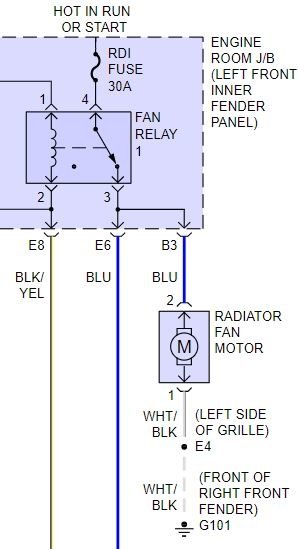

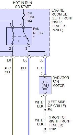

One thing struck me as odd, what you said, " The temperature gauge pointed to high, but when I turn on to AC while I am driving the temperature gauged goes back to some what to normal. "
That is exactly opposite of how it should behave, when turning on the AC usually the cooling system will get a bit hotter, because the AC condenser now is getting hot and it sits right in front of the radiator, thus the hot air blowing through the condenser blows right onto the radiator.
Anyhow, since the reservoir is overflowing, try removing the thermostat altogether and having it out just for now until we get the overheating fixed, plus with it out it should bleed the air out instantly.
Let me know if it no longer overheats with the thermostat out or if it still does and if it still does, make sure the cooling fan runs when the engine gets hot.
The passenger side fan is for when the AC is turned on, so I assume that is why the temperature may be lowering. Check if the drivers side fan runs when the engine gets hot. I assume maybe only the AC fan is working. You could try that even before removing that thermostat.
If the drivers side fan does not work when hot, check the rdi fuse in the junction box under the hood, left front inner fender panel. If it is okay, try a new fan relay #1 same j/b.
May 21, 2018 at 11:13 AM

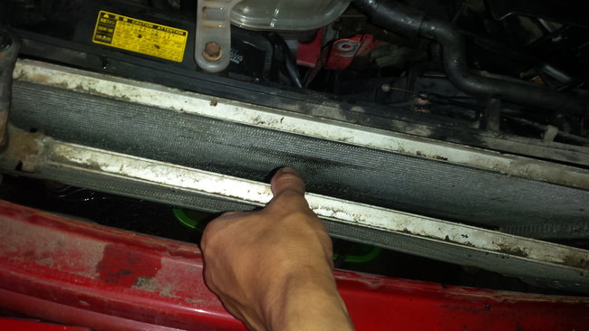

You may have poor coolant flow through that radiator. After the engine warms up shut it off and feel over the entire core of that radiator. The entire surface should be hot, if you find any cooler spots, that may indicate a clog. Make sure no tubes have been cut out of that radiator and if it does have cool spots and no cut tubes, you could try a coolant flush but if you already did that, and you have cool spots, you may need a new radiator or that one rotted out. A radiator shop can do that.
Another possibility if the radiator is fine is the water pump being weak, so if the radiator checks out fine you may want to install a new water pump but first make sure the bottom radiator hose is not soft and sucking closed when the engine is running and warm.

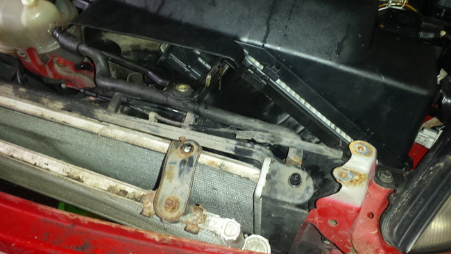

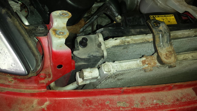

Hello, I started taking apart the radiator. What strikes me is that it looks like there are two pieces of radiator that are currently installed in the car. Is this normal to have to piece of radiator for this type of car?
May 23, 2018 at 1:14 PM
PATENTED_REPAIR_PRO
  • 1,853 POSTS
The one toward the front is the air conditioner condenser.
May 23, 2018 at 2:35 PM
