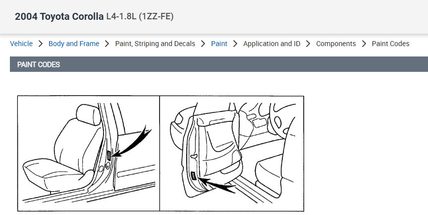

If they are plastic components, you need to have a flex additive in the paint to prevent cracking.
Also, you will want to match the color. There are a million shades of silver. Your vehicle will have a paint code. Use that to get the correct color.
I attached a pic below showing where the paint code should be listed. It will have three characters (numbers or letters or both)
Let me know if this helps.
joe
See pic below.

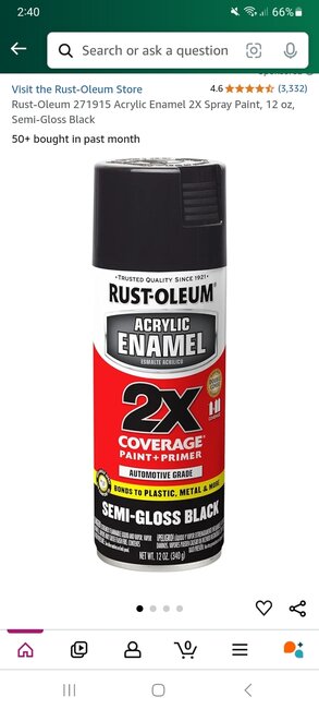

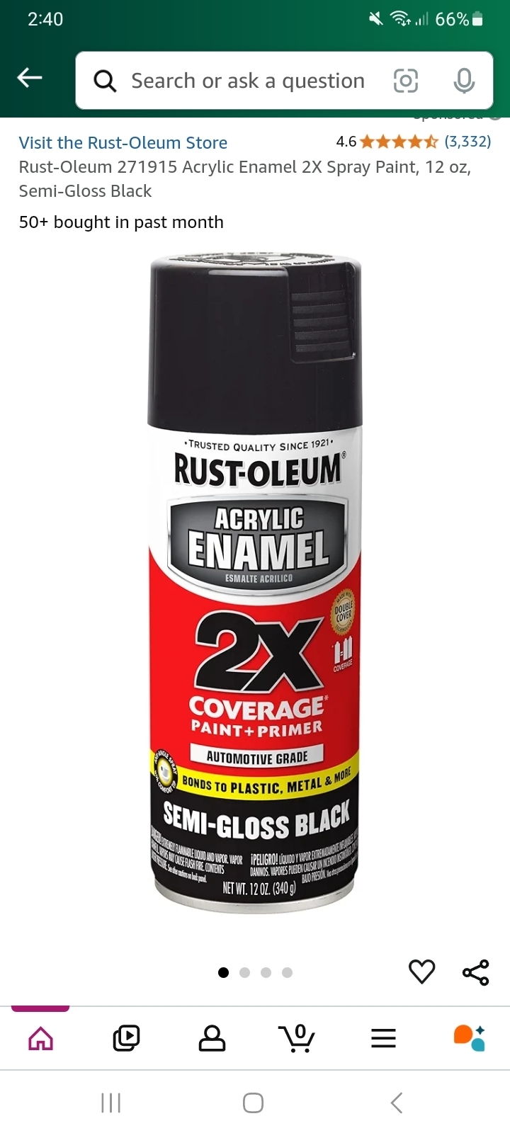

Something like this can work?
Nov 15, 2024 at 2:41 PM
  • 110,193 POSTS
If you have the correct color, it should. I noticed that the label indicates automotive and plastic. So, I would think it is what is needed.

I meant can I use that to paint my car another color entirely, along with using primer and clear coat?
Nov 16, 2024 at 12:40 PM
  • 110,193 POSTS
Yes, it can be used on your vehicle, but it is black. Also, it is an acrylic enamel paint. You don't use a clear coat with it.

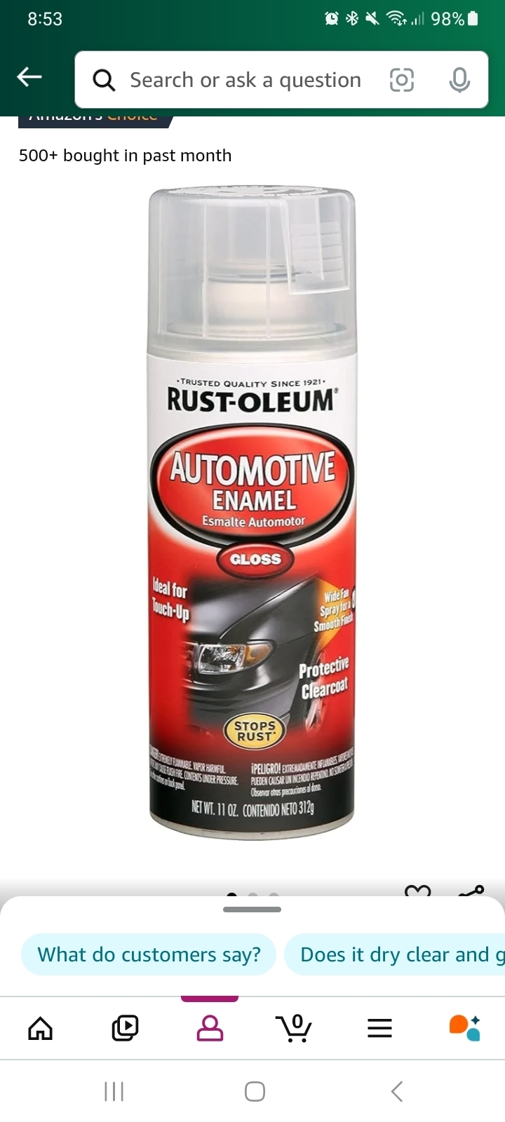

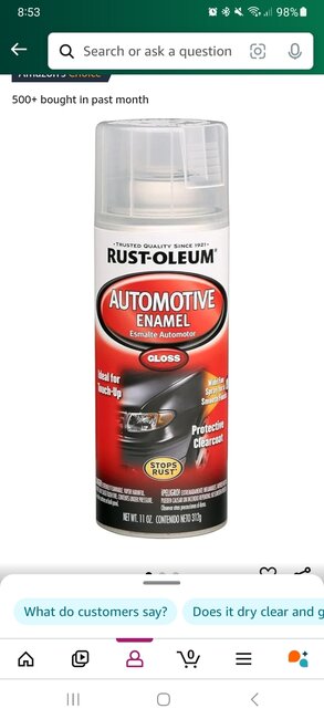

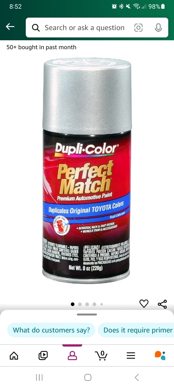

Can i use these 3 together?
Nov 16, 2024 at 8:54 PM
  • 110,193 POSTS
Make sure the Dupli-color requires a clear coat. As far as the primer is concerned, it should be fine. After painting with the primer, allow it to fully dry and then wet sand with 1000-grit paper.
