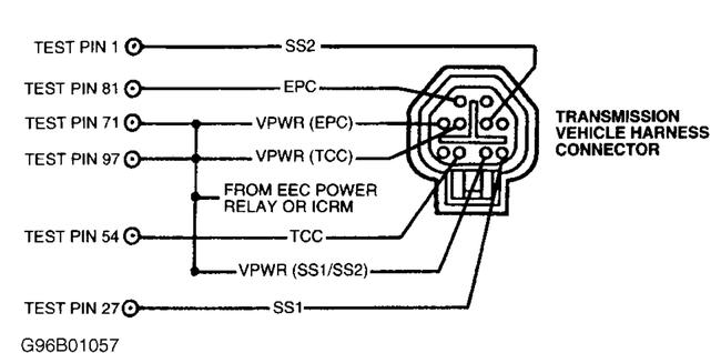

My mustang start flashing the o/d light and i received the error code P1747. The car is not shifting and is working very bad. Is this the electronic pressure control solenoid? Where can I find this solenoid and when I change it the problem is solved?

this can be internal trans damage and or a pcm etc. check pin 81 to seeif you are getting power. then activate the corresponding pin on trans to see if you can hear solenoid work if you do then it's either a trans problem or a pcm an dthen have apro diagnose it.

Where is this transmission vehicle harness connector located?

onside of trans driver's side
