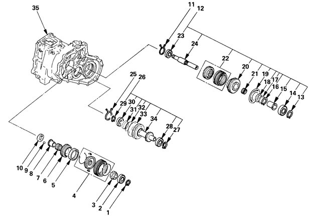

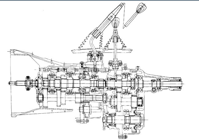

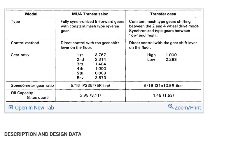

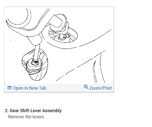

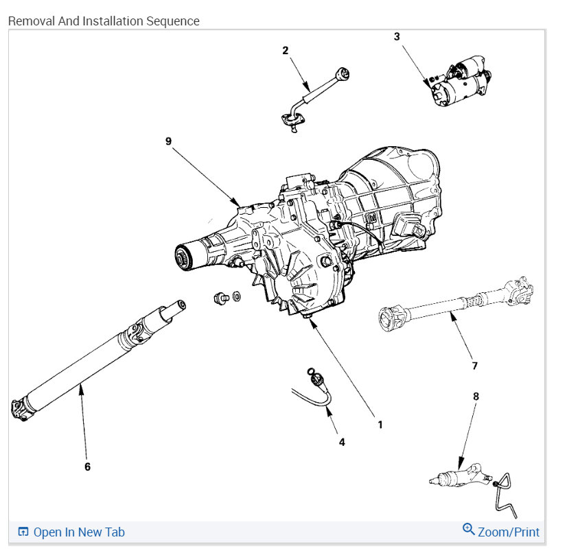

This is a full manual transfer case system, I would remove the gear selector and see if it is installed correctly, the selector rod might be off. Check out the images (below). Please let us know what happens.
