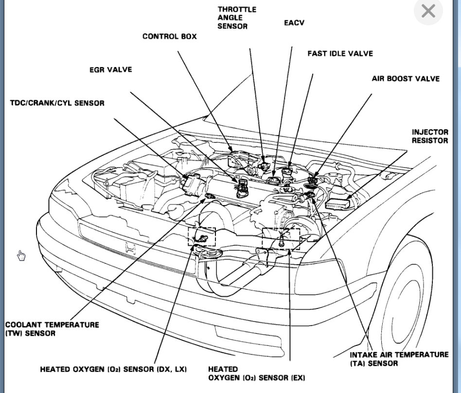

Oxygen sensor location(s) for replacement?
155,254 MILES • 3.5L • 6 CYL • 2WD • AUTOMATIC
PETER PATTERSON
just need to know where they are and which is b1 and b2? that is all they told me when i had it scanned.
Oct 10, 2019 at 5:12 AM

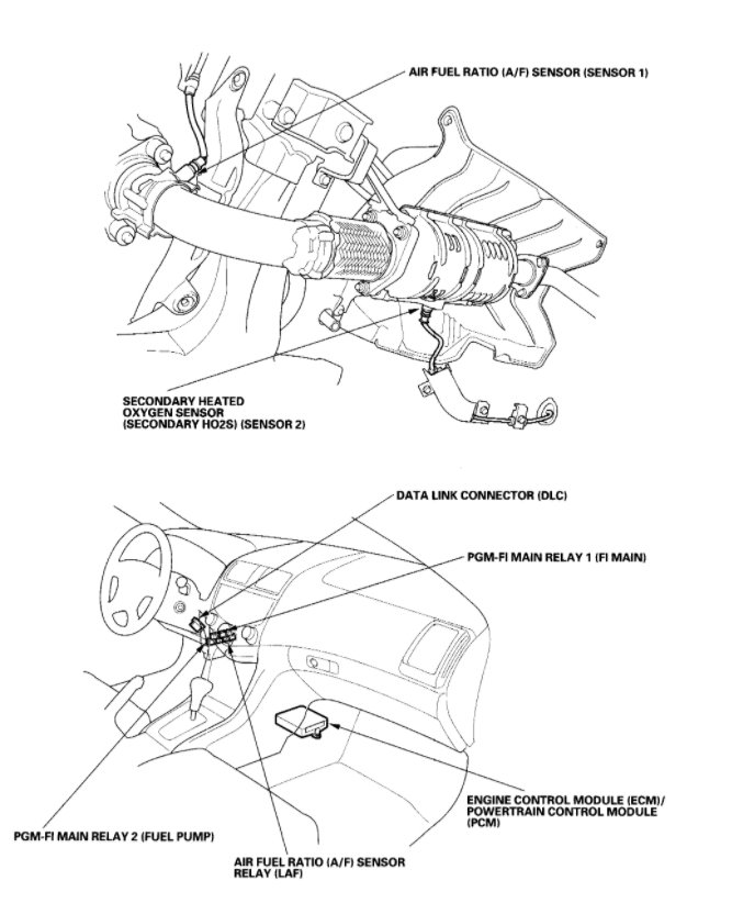

Good evening,
I attached a picture of the sensor locations for you to view and a guide to help walk you through the repairs with diagrams below to show you how on your car.
https://www.2carpros.com/articles/how-to-replace-an-oxygen-sensor
What are the codes? Rarely O2 sensor codes require replacement of the actual sensor.
Oct 10, 2019 at 7:42 AM
PETER PATTERSON
p0430 theshold B2
p0420 theshold B1
p0430 theshold B2
Oct 10, 2019 at 9:30 AM
Okay, you need catalytic converters. The precious metals are worn out in the converters. It is not the sensors at all, it is the catalytic converters.
Oct 10, 2019 at 9:44 AM

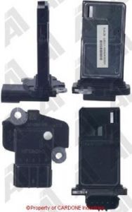

JERRYJIMENEZ36
  • 5 POSTS
Ok So I looked at my mass airflow sensor and its different from the picture you sent me. My mas airflow sensor has five
https://images.2carpros.com/forum/automotive_pictures/479912_getimage_1.jpg
prongs and there all inline isntad of a four prong.
Jun 25, 2021 at 2:36 AM (Merged)
RACEFAN966
  • 5,029 POSTS
Ok what sub model is you Accord? Is it an EX LX or a Hybrid or ?

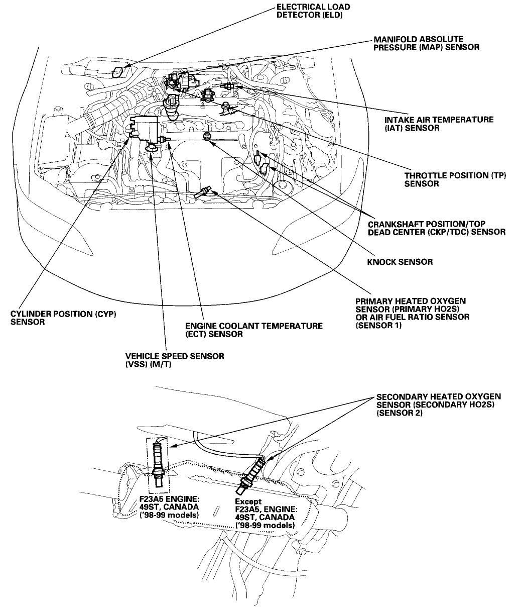

HONDA TECH 1818
  • 536 POSTS
There are two sensors. The air fuel ratio sensor is located at the A-pipe and the secondary oxygen sensor in the catalytic converter. It depends which code was stored. I would use oem parts.

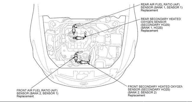

HEMANKAPS
I have 2003 Honda Accord V6. Recently my Check Engine light came up. On checking the code, it showed P2251/P0134 which are for Bank1 Sensor 1. I was able to locate this sensor as on the backside of the engine.
I tried to open it, but I ran into problem when the sensor cable which is plugged with a male/female coupling did not come out. There is verly little space to move your hand and it seems to be very tight.
Please suggest any tool or how I can take this out?
I even tried to pull the coupling for the front sensor 2, but that too was very tight and could not open.
Quick response is appreciated.
Thanks

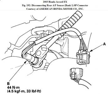

KHLOW2008
  • 41,812 POSTS
Hi Himanshu, Thank you for the donation. There is no special tools for unplugging the terminal. The wireharness side has a locking tab that has to be pressed to release the lock before you can pull the connector off. Sometime sand or dirt gets between the tab rendering it impossible to release the lock. I would use compressed air to blow out any foreign material before pressing the tab.
https://images.2carpros.com/forum/automotive_pictures/192750_AFSensor03Accord_1.jpg
Jun 25, 2021 at 2:39 AM (Merged)

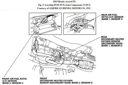

HEMANKAPS
Thanks for the reply.
I will try to put some lubricant. And just to confirm, the Bank 1 Sensor 1 is located on the back side of the engine, right?
KHLOW2008
  • 41,812 POSTS
Yes, Bank 1 is rear sensor.
https://images.2carpros.com/forum/automotive_pictures/192750_O2Sensor03Accord_1.jpg

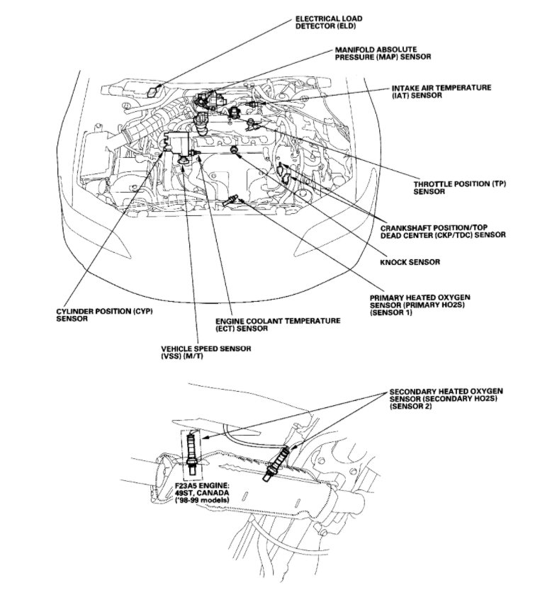

WAKEDOG38
It is a 2.3l california emissions, I've had a pesky check engine light off and on for the last couple of months. I had a diagnostic done and was told I need to replace the B1 S2 sensor. After scouring the web I can't get a solid answer on where the sensor is located. Any help would be appreciated. Thanks
Jun 25, 2021 at 2:40 AM (Merged)
  • 75,988 POSTS
Here is a guid to help you change the oxygen sensor out and the locations of the sensor for your car below.
Sensor 2 would be in the catalytic converter.

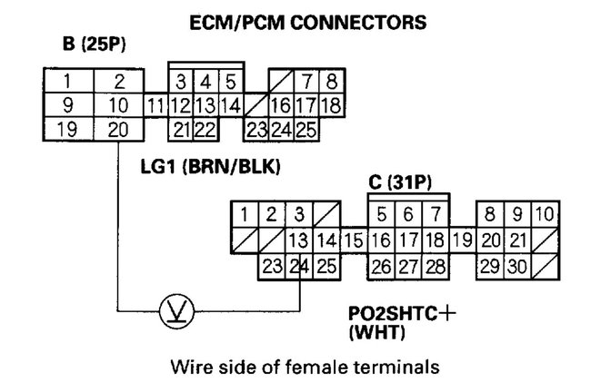

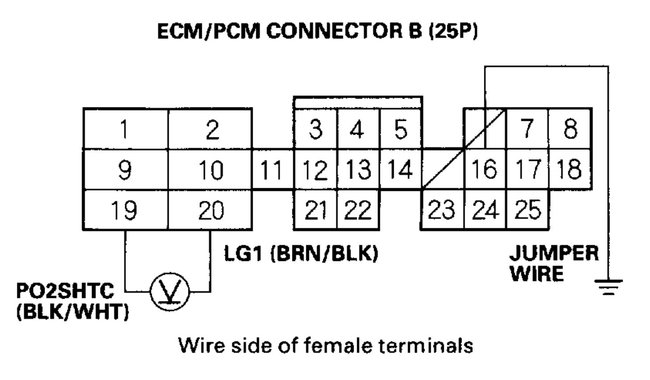

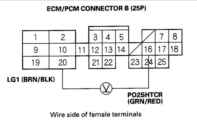

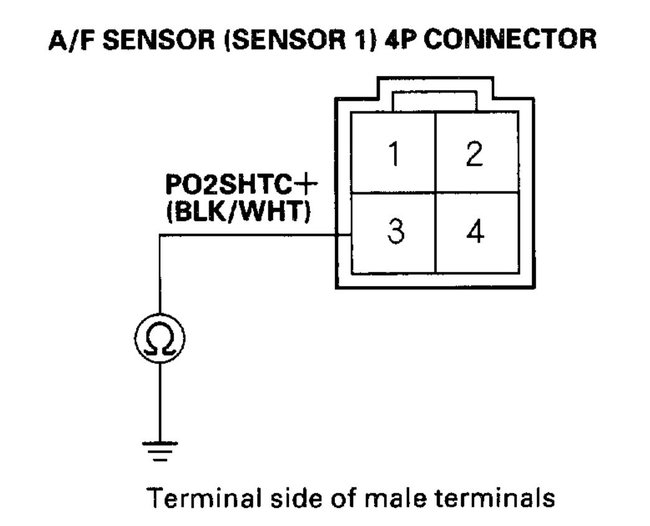

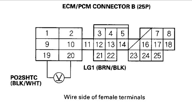

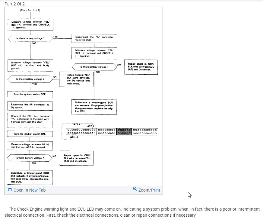

SYANG2005
Hi Have 2001 accord, 4dr, 4Clynder, model. Got error codes P1166 and P1167 indicating O2 sensor issue. How do I know which one, Bank1 or 2 and if Bosch aftermarket sensor is good enough for replacement. Thanks!
Jun 25, 2021 at 4:09 AM (Merged)
F4I_GUY
  • 3,302 POSTS
Those are both codes for Bank 1 A/F sensor heater. See diagnostic chart below
DTC P1166: A/F Sensor (Sensor 1) Heater Circuit Malfunction
1. Reset the ECM/PCM.
2. Start the engine.
Is DTC P1166 indicated?
YES - Go to step 3.
NO - Intermittent failure, system is OK at this time. Check for poor connections or loose wires at C102 (located under the under-hood fuse/relay box), A/F Sensor relay, the A/F Sensor (Sensor 1) and the ECM/PCM.
3. Check the following fuses:
- POWER SEAT (20 A) fuse in the under-hood fuse/relay box.
- No.4 ECU (ECM/PCM) CRUISE CONTROL (15 A) fuse in the driver's under-dash fuse/relay box.
- No.6 LAF HEATER (20 A) in the passenger's under-dash fuse/relay box.
Are any of the fuses blown?
YES - Repair short in the wire between the A/F Sensor relay and the fuses.
NO - Go to step 4.
4. Measure voltage between ECM/PCM connector terminals B19 and B20, 30 seconds after the ignition switch is turned ON (II).
Is there battery voltage?
YES - Substitute a known-good ECM/PCM and recheck. If the symptom/indication goes away, replace the original ECM/PCM.
NO - Go to step 5.
5. Measure voltage between ECM/PCM connector terminals C13 and B20.
YES - Go to step 6.
NO - Go to step 10.
6. Turn the ignition switch OFF.
7. Disconnect ECM/PCM connector B (25P).
8. Turn the ignition switch ON (II).
9. Connect ECM/PCM connector terminal B16 to body ground with a jumper wire, then measure voltage between ECM/PCM connector terminals B19 and B20.
NO - Repair open or short in the wire between A/F Sensor (Sensor 1) and ECM/PCM (B19).
10. Turn the ignition switch OFF.
11. Disconnect ECM/PCM connector B (25P) and the A/F Sensor (Sensor 1) 4P connector.
12. Check for continuity between A/F Sensor (Sensor 1) 4P connector terminal No.3 and body ground.
Is there continuity?
YES - Repair short in the wire between the A/F Sensor (Sensor 1) and ECM/PCM (B19).
NO - Go to step 13.
13. Turn the ignition switch ON (II).
14. Measure voltage between ECM/PCM connector terminals B16 and B20
YES - Repair open in the wire between the ECM/PCM (C13) and the A/F Sensor (Sensor 1) or Secondary HO(2)S (Sensor 2).
NO - Go to step 15.
15. Check for continuity in the wires between A/F Sensor and the fuses.
YES - The wires are OK. Replace the A/F Sensor relay.
NO - Repair open in the wire between the A/F Sensor relay and the fuses.
The corresponding diagrams are attached below

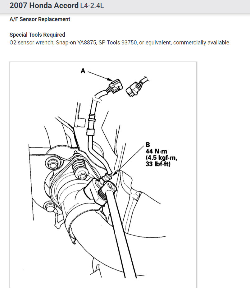

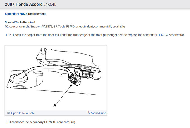

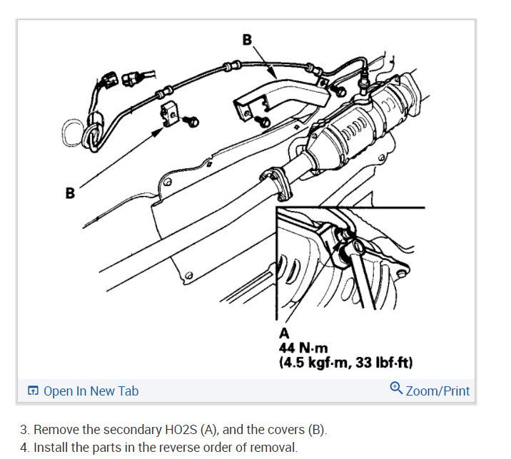

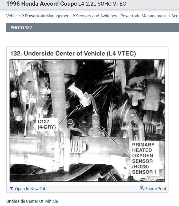

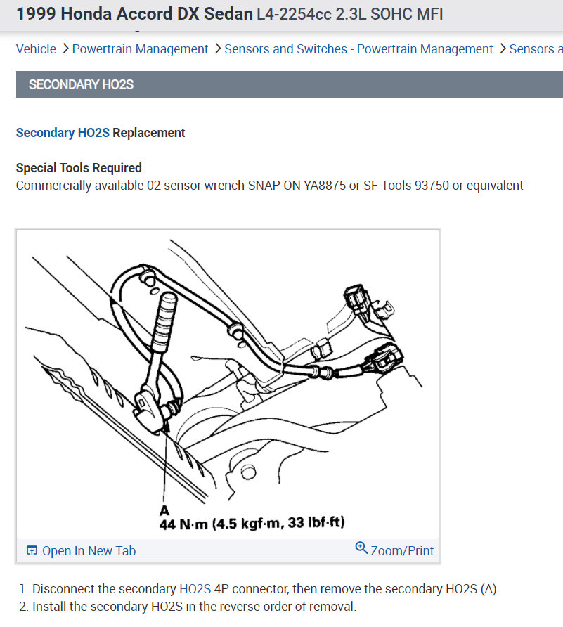

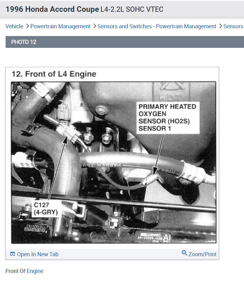

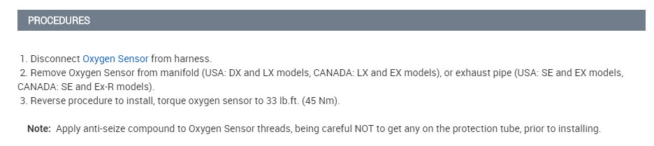

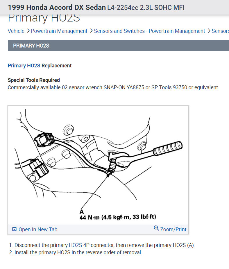

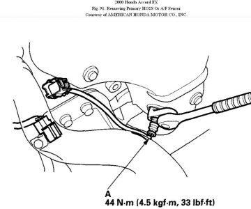

WICK333
I'm replacing the exhaust, from sleve (that is in-between the manifold and the cat) to the back. I have the cat disconnected and it is attached only by the o2 sensor wires. Does the o2 sensor unplug or do you need to remove the nut at the base (there is no room to get a wrench on it with any leverage) The sensor appears to have three seems where it might pull off/unplug, but I have been unsuccessful in seperating it by pulling on it with a vice grip. I am about to mark the wires and then cut them and then splice them back together.
I live in Minnesota and there has be nothing about this exhaust removal that has been easy. To start I'm doing it with jack stands and really wishing I had a lift. I'm replacing the Cat because I stripped the nuts on the back of the Cat even after WD 40 and a torch. I'd just cut the bolts with a die grinder, but the bolts are welded into the cat. So the nuts have to come off or you need to buy a new catalytic converter....Nice!!!!
Everything on the web is very matter of fact in the description or removing the cat. With vivid descriptions like "disconnect the o2 sensor from the converter" or it is not mentioned at all. Disconnecting the sensor is either so simple that it warrants no explanation or the other left that out to frustrate a weekend mechanic like me.
With me a picture is worth a 1,000 words where does it unplug? and if that nut at the base has to come off is there a special tool and what does the tool look like.
Jun 25, 2021 at 4:14 AM (Merged)
KHLOW2008
  • 41,812 POSTS
Hi Wick333, The HO2S is bolted on. Special Tools Required O2 sensor wrench SNAP-ON YA8875 or SP Tools 93750 or equivalent, commercially available
https://images.2carpros.com/forum/automotive_pictures/192750_HO2SReplacement00Accord_2.jpg

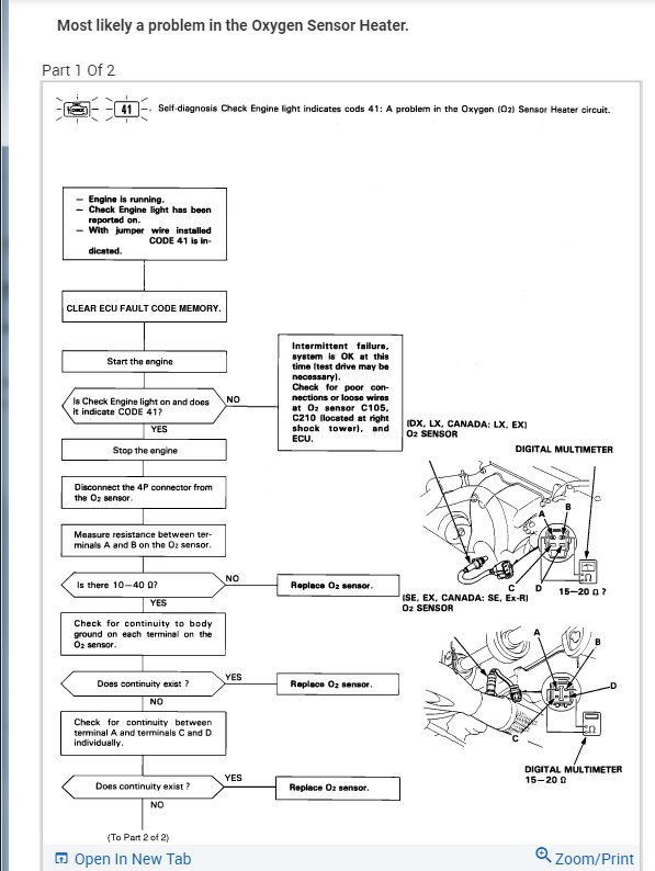

KARL GRAVES
  • 7 POSTS
Where is the oxygen sensor heater located? I got a code 41 today.
Jun 25, 2021 at 4:16 AM (Merged)
I attached the info for this code and the location. This guide will help walk you through the repair with diagrams below to show you how on your car.
Let us know if you have more questions. Check out the diagrams (Below). Please let us know if you need anything else to get the problem fixed. Thanks
