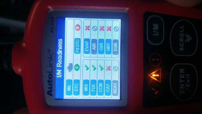

Okay Ken,
I'm attaching a screenshot.
The current codes are as follows:
P0458
P2092
P2094
P0365
P0348
P0393
P0300
P0301
P0305
Please let me know if this is what we need.
Thanks,
Sam

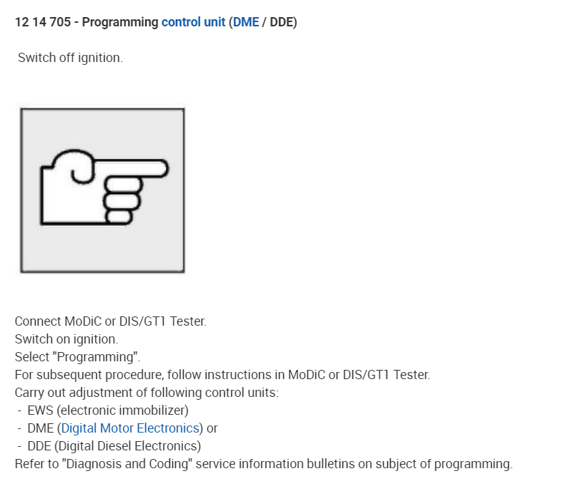

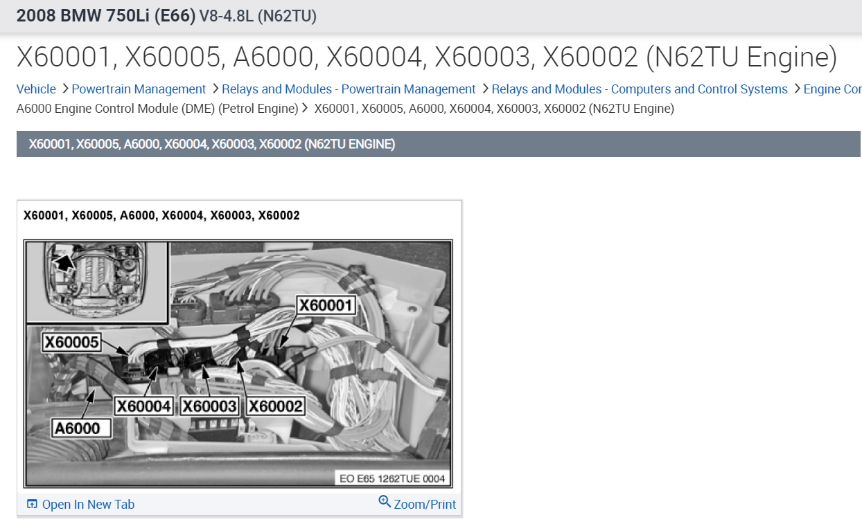

Yes, this is pointing to the DME module being bad, here are instructions on how to replace the unit. Check out the diagrams (below). Please let us know what happens.

In looking at your reply and the attached images, I'm not seeing any instructions for replacing the module.

This is all they offer as far as instructions go, did it fix the problem?

Okay, swapped out the part and the engine turns over but won't start, which is new.
It's giving me the following codes:
P0458
P2092
P2094
I erased the codes and am charging the battery and will see what codes show up after that.
I'm confident that I installed it correctly, but if it still won't start I'll go back in and double check, reinstall the old one to see if it starts with that one, etc, to try to troubleshoot.
Saturday, June 11th, 2022 AT 11:13 AM
SAM CRENSHAW
  • 52 POSTS
Reinstalled. Same results. Put the old one back in, started right up, but of course with a bunch of error codes:
P0458
P2092
P2094
P0365
P0348
P0393
P0300
P0301
P0305
So, it looks like I bought a bad DME. I'll find another one and try again.

Ken, these DMEs have to be programmed to the car, no? Isn't that why it wouldn't start?
Tuesday, June 14th, 2022 AT 11:50 AM
KEN L
  • MASTER CERTIFIED MECHANIC
  • 55,266 POSTS
Yes, they need to be programmed to the car, many online services can do this for you.
