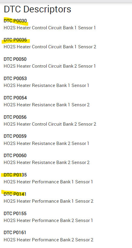

Hello, these are all Oxygen sensor heater circuit codes. What brand sensor did you put in for the first one?

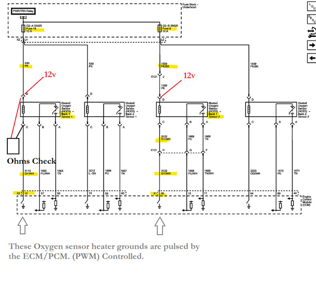

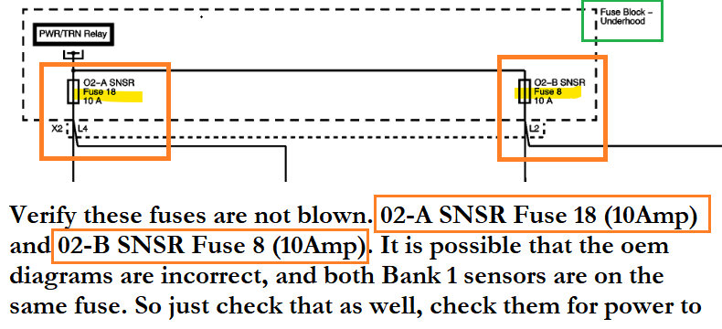

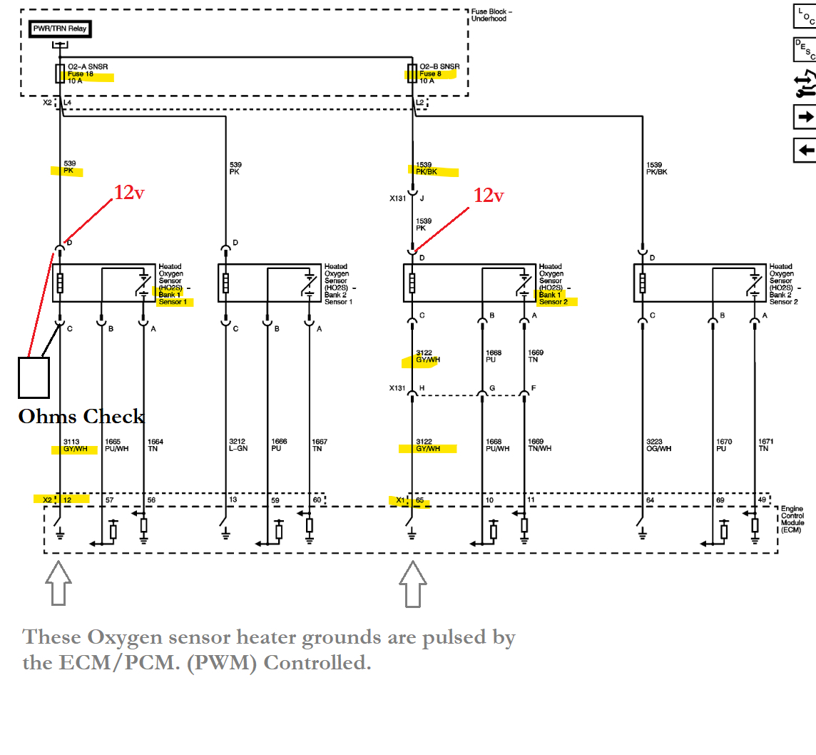

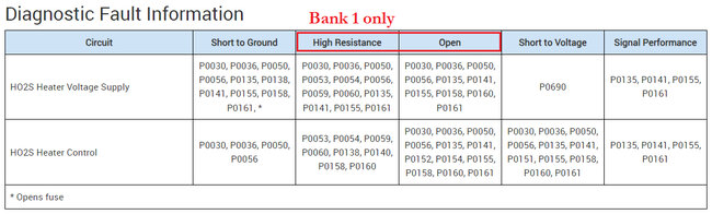

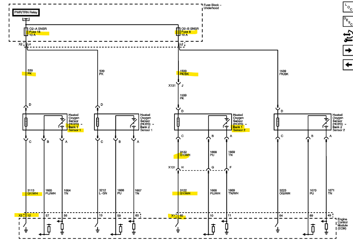

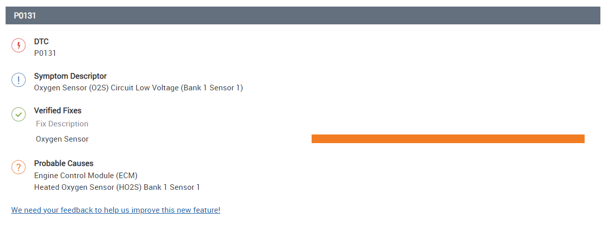

These codes are all caused by the heater circuits for both Bank 1 02 sensors, I would check the resistance of the Bank 1 Sensor 1 you installed first. If the heaters are not working the sensors will not work correctly. The heater is the 2 wires of the Bank 1 and 2 oxygen sensor 1 is a pink power feed. So, with the key on you should have battery power on the pink wire of both front 02s. They are both powered by the same fuse according to the OEM diagrams. So, I don't think it's a fuse issue. But I'll post the wiring diagrams for them all.

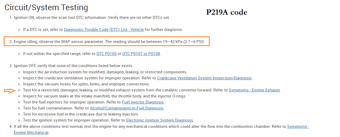

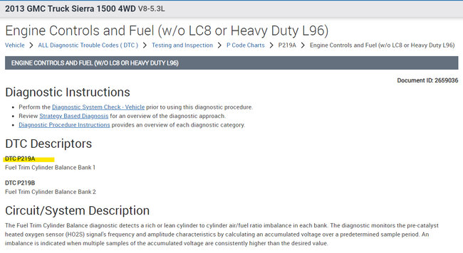

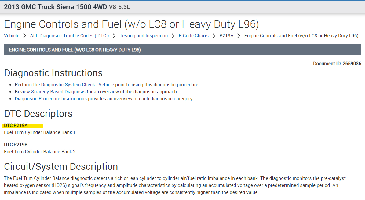

But check for power anyway, The P219A code is a Fuel Trim Code for Bank 1, that's due to the 02 sensor issues. This seems to be all confined to one side of the engine. So, check the connectors and wiring for both Bank 1 sensors.

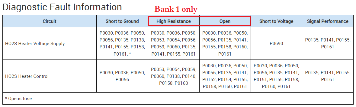

These are the OEM 02 wiring diagrams, it might be that the Bank 1 sensors are having connector issues or melted wires on the exhaust. With both sensors setting low voltage codes, that's why you're smelling gas, the 02 sensors are sending skewed data and the PCM is enriching the mixture on Bank 1 due to the low voltage reading.
The time delay is the switching frequency of the sensor being too slow.

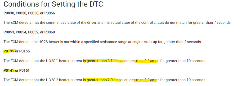

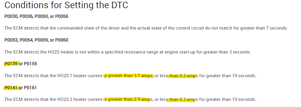

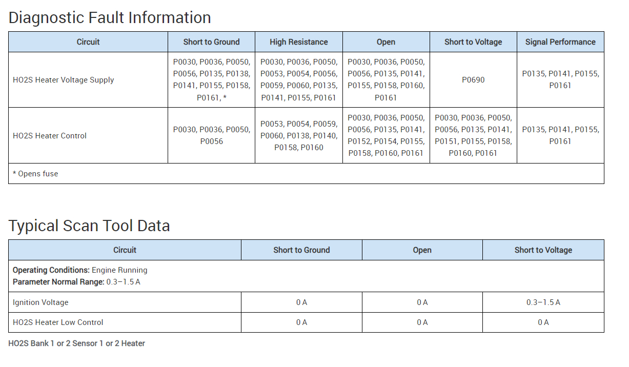

The codes are setting on the heater circuits due to too much current flow or not enough that is being monitored on the heater control circuit inside the PCM. If it was a short to ground it would blow the fuse and codes for Bank 2 would set as well, so it has to be an open circuit or high resistance for the Bank 1 sensors.
The 3rd diagram shows checking power and resistance of the heater check.

The Bank 1 side of the engine may be flooding out, I wouldnt drive it until you get this resolved or you can damage the Catalytic Converter for that side. Overly rich mixture will melt down the converter and restrict the exhaust. When the 02s read low voltage, thats sending a lean signal to the ECM/PCM and it is compensating for that by overly enriching the mixture. Make sure you unplug both Bank 1 sensors, and check the resistance of each, after you check for 12v feeds. You can compare the resistance reading to the Bank 2 sensors. The Oxygen sensors may change wire colors after the connectors, so they may be the same color at the sensor. Usually they are 2 white wires at the sensor.

Check these fuses as well, make sure they're not blown, and both have 12-volts.

Happy New Year to you, I finally had a chance to look and my truck today. Here is what I found, I checked the fuse for the o2 sensor for bank 1 and it was good. I checked power going across the fuse with key on 12 volts spot on. So I moved down to the sensor itself and checked with my fluke meter to see if the heater was good and I found that the heater was open on both sensors 1 and 2 so I took those sensors out and took them back to the parts store and exchanged them. I installed them stared up my truck and let it get up operating temperature and the truck is running good. No rough idle or miss. Thank you for the help.
