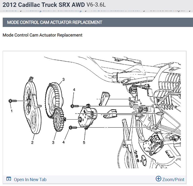

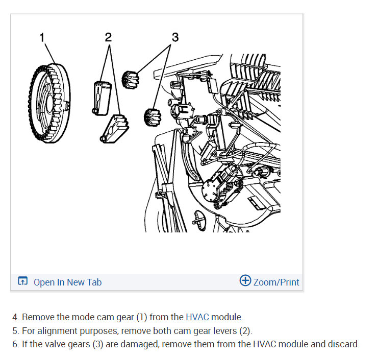

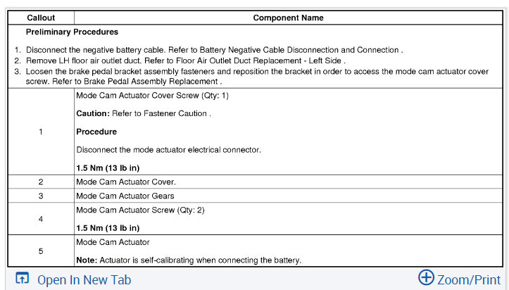

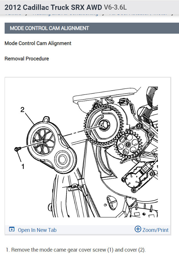

Where is the Mode door actuator located and how to replace it?
2012 CADILLAC SRX
207,000 MILES
ROBERT BILBY
How to locate and replace mode door actuator?
Jan 21, 2024 at 6:33 AM
  • 54,840 POSTS

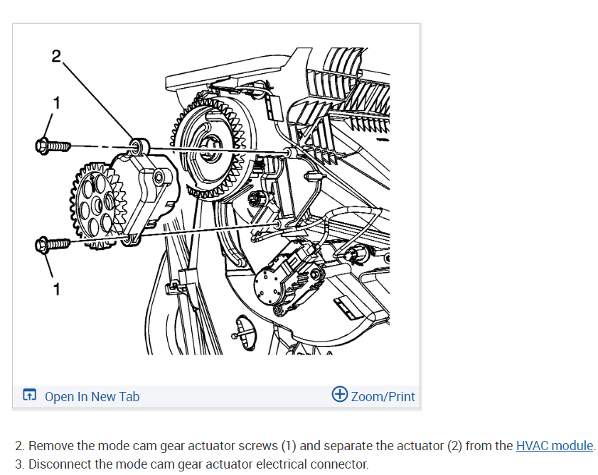

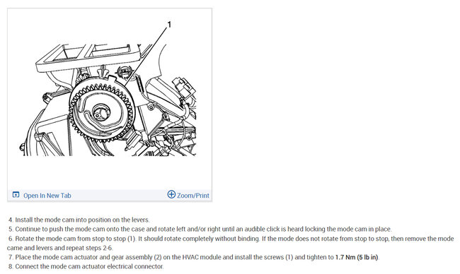

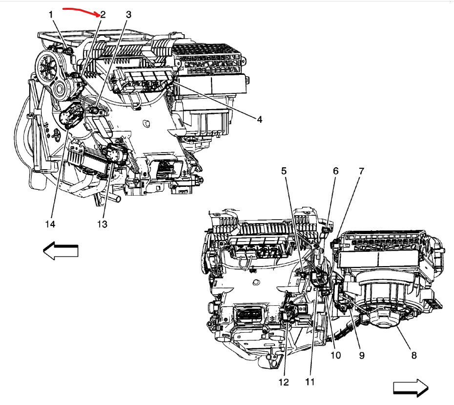

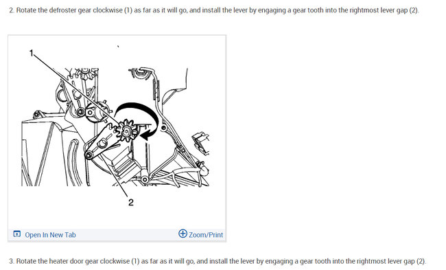

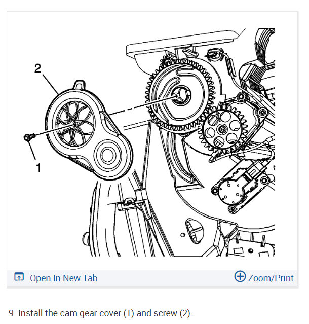

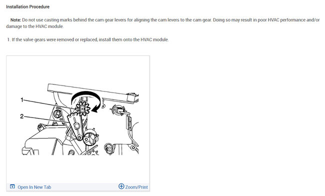

Here is the location of the mode door actuator but I must say there is a cam and gear assembly that may need attention as well because these gears are made of plastic and can brake causing the actuator not to work. The actuator is located on the left side of the HVAC plenum above the accelerator pedal. Check out the images (below). Please upload pictures or videos in your response of the problem so we can see what's going on.
