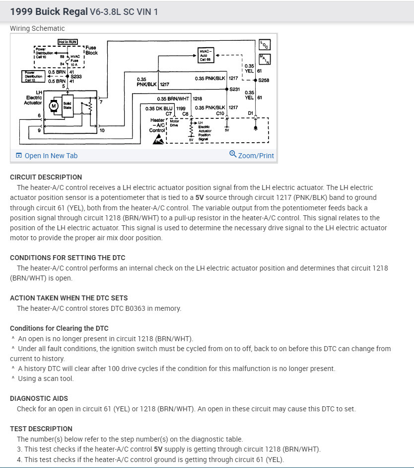

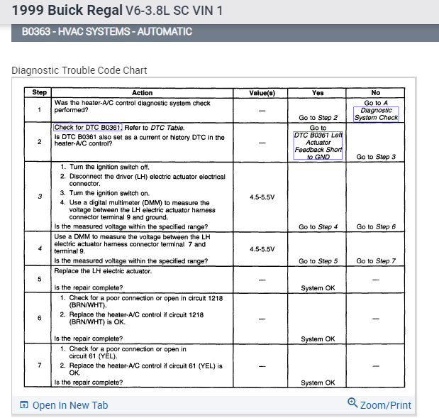

SQM
  • CAR REPAIR CONTRIBUTOR
  • 6,383 POSTS
The noise you are describing sounds like the noise that the supercharger makes as you accelerate, which is completely normal operation on a supercharged engine.
If you would upload a video clip of the noise, that can help us determine.
The code B0363 is a HVAC code and not related to the noise you hear.
See attached diagnostics information.
Let me know of any questions.
May 10, 2022 at 8:06 PM (Merged)
