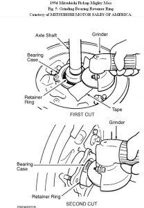

My pickup needs new inner and outer seals on the axles. I have removed the axles and the inner seal is a typical installation. The outer seal requires the removal of the bearing and bearing housing. The bearing appears to be pressed on with a retaining ring on the inner side. There does not appear to be any way to press the housing and bearing off without pressing on the outer bearing race and damaging the bearing. There must be a way to replace the two dollar seal without damaging the fifty dollar bearing. Please help!

1. Secure axle shaft assembly in a vise, and remove one retainer bolt from backing plate. Push bearing case completely to side of dust cover. Place adhesive tape around edge of bearing case at retainer bolt hole to prevent damage.
CAUTION:DO NOT damage bearing case or axle shaft when grinding or chiseling retainer ring.
2. Secure axle shaft, and grind retainer ring until retainer ring wall thickness is .04-.06" (1.0-1.5 mm) on axle shaft side and .08" (2.0 mm) on bearing side. See Fig. 5 .
3. Change angle of grind, and remove remaining .08" (2.0 mm) of retainer ring wall on bearing side. See
Fig. 5 . Using a chisel, cut retainer ring. Remove ring.
DO NOT damage axle shaft.

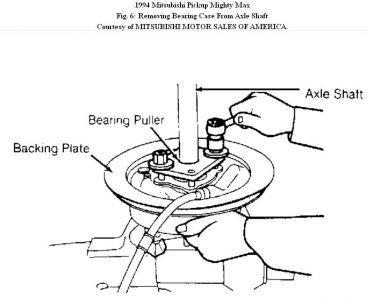

4. Install Puller (MB990787-01) to remove bearing case from axle shaft. See Fig. 6 . Rotate nuts with equal force to remove wheel bearing. Remove bearing outer race using a hammer and drift. Remove oil seal from axle housing using a slide hammer and hook.

If you do not have the puller, you can try this. After removal of the retainer ring, with a hard wooden block on a flat and sturdy surface, lift the axle with the backing plate on top and hammer the axle onto the wooden block.
The weight of the bearing housing and backing plate would enable the bearing to be slowly pushed outwards. Might require some hammering.
