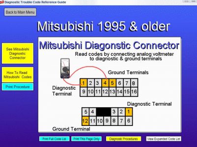

1991 Mitsubishi V6 Four Wheel Drive Automatic 126245 miles
Please Help me. I have a 91 Mitsubishi Montero and the Check Engine Light is on.I want to Check the codes to see what is wrong but I can't find the plug that is listed on my repair manual. I check all over under the dash and next to de ecm and still don't see the plug. Thank you for your prompt respond.

Don't know exactly where it is, but this is what it looks like and how to hook up. Drive to a mtsu dealer and they will show you where the connector is.
https://www.2carpros.com/forum/automotive_pictures/62217_Connedtor_1.jpg
