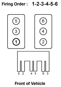

I'm getting a P0155 error code. My reader says it's Bank 2, sensor 1. Where is Bank 2 sensor located on the engine. I'm at the front of the car facing the engine.

Here is a guide to help you step by step with instructions in the diagrams below to show you how on your car.
https://www.2carpros.com/articles/how-to-replace-an-oxygen-sensor
https://www.2carpros.com/forum/automotive_pictures/99387_02__1V6_2.jpg
https://www.2carpros.com/forum/automotive_pictures/99387_Graphic1_408.jpg
Bank one is where cylinder # 1 is
bank two is where cylinder # 2 is
good luck

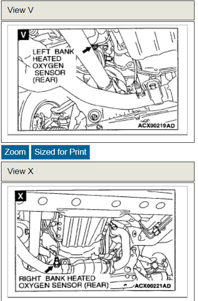

I need to find out where the oxygen sensor bank2 sensor 2 is on a Mitusbishi Montero.

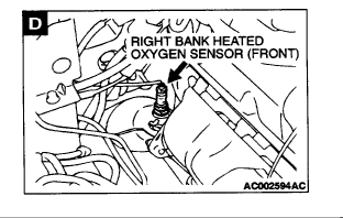

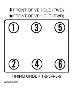

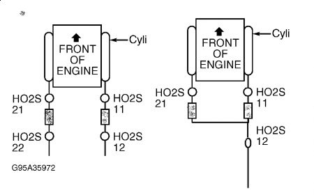

IMPALASS
  • 3,112 POSTS
Hello
Right exhaust, second sensor. Bank 2 is on the same firing side as cylinders 2, 4 and 6 which looks like the drivers side. Bank 1 is always on the same side as #1 cylinder.
https://www.2carpros.com/forum/automotive_pictures/248015_3_34.jpg
https://www.2carpros.com/forum/automotive_pictures/248015_2_49.jpg
https://www.2carpros.com/forum/automotive_pictures/248015_1_69.jpg
+9
Monday, December 28th, 2020 AT 1:30 PM (Merged)

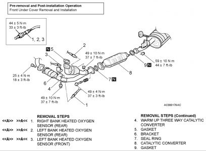

DMG62
  • 2002 MITSUBISHI MONTERO
  • 6 CYL
  • 2WD
  • 93,000 MILES
How many Oxygen Sensors does a 2002 Mitsubishi Montero Sport XLS (3.5L) have?

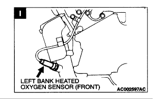

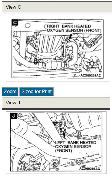

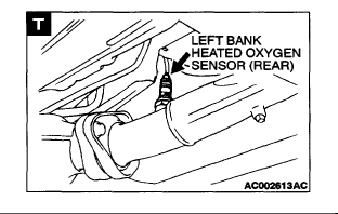

  • 75,992 POSTS
Heated Oxygen Sensor (Left Bank) (Front). In left exhaust pipe, below exhaust manifold.
Heated Oxygen Sensor (Rear) (Left Bank). Underside of vehicle, rear of catalytic converter.
Heated Oxygen Sensor (Rear) (Right Bank). Underside of vehicle, rear of catalytic converter.
Heated Oxygen Sensor (Right Bank) (Front). In right exhaust pipe, below exhaust manifold.
+4

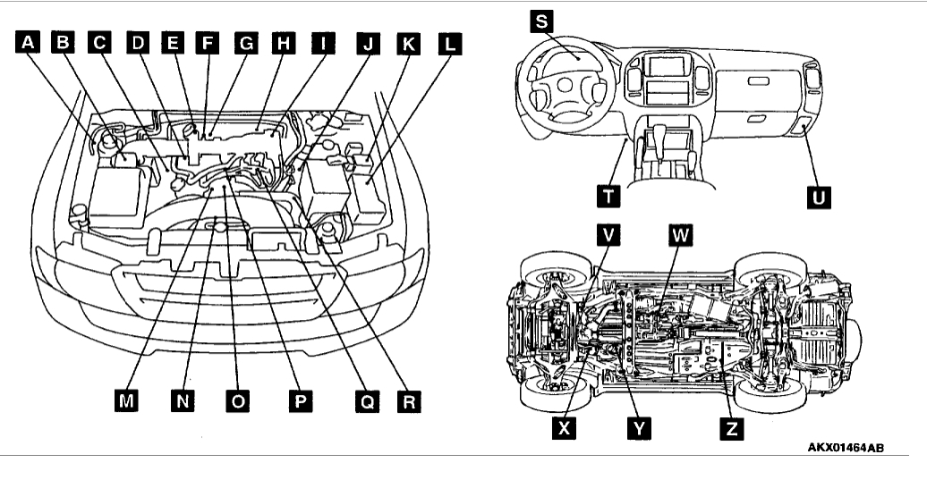

Engine Performance problem 6 cyl Two Wheel Drive Automatic 120000 miles
This Vechicle recently failed a Nevada Smog Test, The test results said, data trouble codes indicate p0154 O2 Sensor circuit no activity detected (Bank 2 Sensor 1). What I need to know is This the front right(passenger side) Sensor of the 4 Total O2 Sensors that this vehicle has?

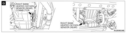

KEN L
  • MASTER CERTIFIED MECHANIC
  • 55,291 POSTS
Here is a guide that will help you see what you are in for when changing out the oxygen sensor.
Here is the location of the sensors in your car (Below)
+2

IMPALASS
  • 3,112 POSTS
Hello, bank one is the right side of the engine. first I show several different Montero 4WD models. I am going with Sport ES. The truck has 4 Oxygen sensors on it. I have attached the pics. You really need to know what the codes are. There are a couple of technical service bulletins out, but again, need to know the correct model of the vehicle and what the codes were. Stop by Auto Zone or O'Reilly's. For free they can pull the codes and if it is an O2 sensor, it will tell you what position. I would be more concerned with what sensor they changed and what code they saw. As for the oil. . .. . .well, there is a slim possibility. It does raise the question that if it were that new it should be more durable..........it does kind of make you say. These are heated and any fluid that would interrupt the connection may cause a problem. It is possible you had two sensors go bad. Let's check the codes first. Where is the oil coming from would be my next concern especially if it was running down the cable. Let us know
https://www.2carpros.com/forum/automotive_pictures/248015_Oxy_1_1.gif
https://www.2carpros.com/forum/automotive_pictures/248015_Oxy_2_1.gif
https://www.2carpros.com/forum/automotive_pictures/248015_Oxy_3_1.gif
https://www.2carpros.com/forum/automotive_pictures/248015_Oxy_4_1.gif
