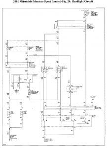

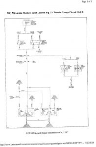

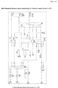

Hi, Was Anything Installed recently ,Like a Radio,or A alarm? Here Are the Circuit diagrams They Show You Where the grounds are ,And Wiring. I Wish I Could be more help, but i'm not there .Sounds Like a Ground Problem .Also Check all your Bulbs Make Sure They Are The Right For that car .Also look At the turn signal Bulb That the filaments in the bulb Are Not shorted together.

Hi, Looking at Diagram three. Look At Joint Connector Three At left side Of dash. Also Look At column switch, These two wires Leading down to Joint connector Three. Orange/blue wire and Green/white wire. See If these Wires Are Fused Together Somewhere Along The way. Also Look for Fused wires At that Joint Connector three.

The wiring diagrams that you sent in your response are very small and when I enlarge them I cannot read them. Are you able to send them to me via email. My email address is

As far as I can tell, those wires are fine. This circuit goes through the ETACS ECU. Do you think that this could be the problem? It says it is under the drivers dash but I cannot seem to locate it. I see the relays and it says it is behind those but the relay board does not seem to be removable.

Hi, I sent them To you Via Email.I don't see any Ecu on My Diagram.

I got the diagrams fine. These are nothing like mine. I have the Mitsubishi shop manual set and my drawings are quite different. I noticed that your drawing said Montero Sport but mine is a regular Montero LTD.
