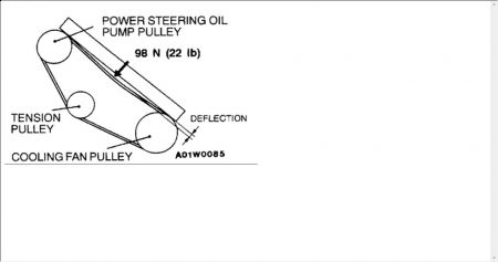

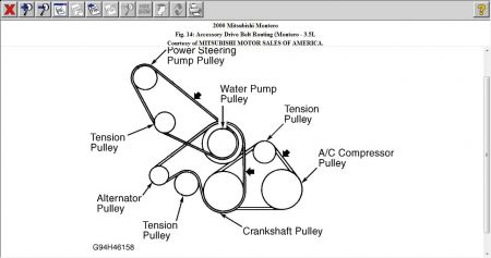

Both my power steering and AC belt broke. I bought the replacements but I have not idea how to loosen the pulleys to get the belts on.
Thanks
Ken
Oct 22, 2009 at 7:22 PM
  • CAR REPAIR CONTRIBUTOR
  • 75,992 POSTS
Hi Kenny2103 and TY for the donation You need to remove the alternator belt too by loosening the tensioner pulley adjusting bolt. When you reinstall the belts 1st put the AC belt,then alternator followed by the Power steering and tension the belt atleast 1/4 deflection from center of each belt Routing:
