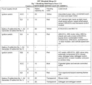

I just bought this montero for $2000, I think I got a good deal, the only issue so far is that the fan does not blow at all hot or cold, I do hear the ac coming on when I turn the fan/ac on but it looks like the blower just wont turn on.

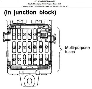

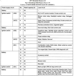

I checked under the hood, I switched the relay from the light to test in fan relay and nothing, I replaced 1 blown fuse #25 (does not say what its for, theres 2 #25's together next to 2 relays) that is located on the outside next to fuse box, nothing...I have not checked the inside fuses yet my tester is too bulky and I have to take out 1 by 1 and there is like 20+ fuses down there.
do you guys have a diagram of the fuse box on the inside of car? its missing the cover, it would really help.
also if the fuses turn out not to be the problem any way to test the blower to make sure its not burned out? and where is it located? or what do you recommend i check next?

Hi FromNYC2Houston, Thank you for the donation. I believe the blower motor is bad and requires replacement. Blower motor is under right dash and has a 2 terminal wire connector. Disconnect the terminal and apply battery voltage to the terminals to test if the motor is bad.

and those pictures look like the diagram cover for the inside the cab fuse box, but I cant read it its blurry, and I have a 32" lcd monitor, if I zoom to 150% it gets more blurry. Sometimes these sites resize the pictures? I dont know if this site resized it down, please email it to me I really need that ejaracil@hotmail.com

I would get the diagrams sent to your email.

makes sence, I will have those 2 checked out and I got the email very clear diagram.
