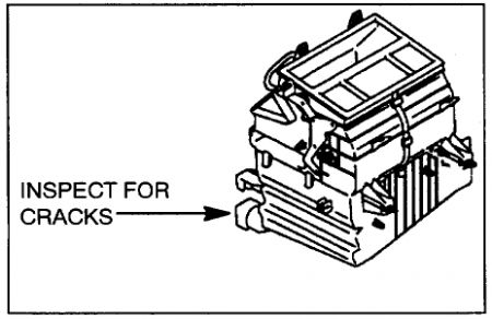

3. Remove the heater assembly. Refer to Group 55 in the appropriate service manual for removal instructions.
https://www.2carpros.com/forum/automotive_pictures/248015_2_92.jpg
a. Remove the evaporator foam pad. Inspect the drain tube on the heater assembly for cracks or other damage that could create leakage. If cracks or other damage are observed, replace the heater assembly.
b. Replace the evaporator foam pad (listed in the PARTS INFORMATION section of this bulletin).

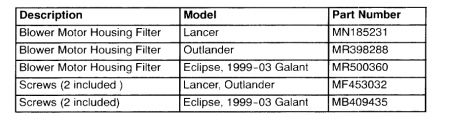

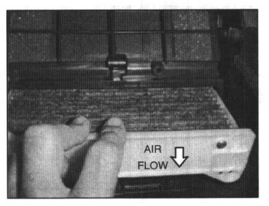

5. Install a blower motor housing filter (listed in the PARTS INFORMATION section of this bulletin) a follows:
a. Use a knife to cut a section from the top of the blower motor housing, along the perforated lines as shown.
https://www.2carpros.com/forum/automotive_pictures/248015_5_27.jpg
b. Install the filter with the air flow directional arrow pointing down.
c. On Lancer and Outlander models only: Secure the filter with two 5X14 self-lapping screws.
PARTS INFORMATION
https://www.2carpros.com/forum/automotive_pictures/248015_6_16.jpg

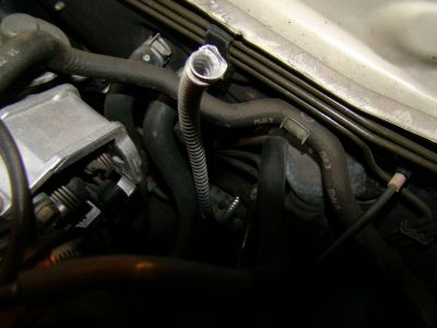

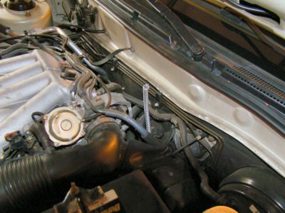

Well it looks like have the same problem with my 2000 Galant. It was leaking condensation onto the passenger side carpet and floorboard. Upon inspection and reading these helpful tips.. I figured that the drain from the condensation pan was plugged up. I thought I would try something besides the $500 dealer fix, and the daunting task of pulling the heater box out to unclog the drain on my own.
I used a two foot long flexible (MC cable) sheath, I'm sure any tubing would do.. I could form a curve at the end that needs to go between the steering cable and firewall where the drain tube exits the firewall. It is in a very tight spot, just under the sound baffle on the firewall and above the steering
https://www.2carpros.com/forum/automotive_pictures/390694_DSC01036_1.jpg
https://www.2carpros.com/forum/automotive_pictures/390694_DSC01037_1.jpg
. The Fix, I formed the flex to go down to the drain tube as it exits the firewall, then I used my compressors air gun to blow air back into the drain., with the aid of the fkex tube.
Immediately there was a wash of water running out, I would say at least a gallon of water ran out.
So I will keep an eye on it and make sure it doesn't clog back up again. I also thought I might do the cabin filter conversion soon and at that time, spray some water through the system to wash out any possible debris that may have collected near the drain again.
Thank you for the tips you gave and for the great site.
