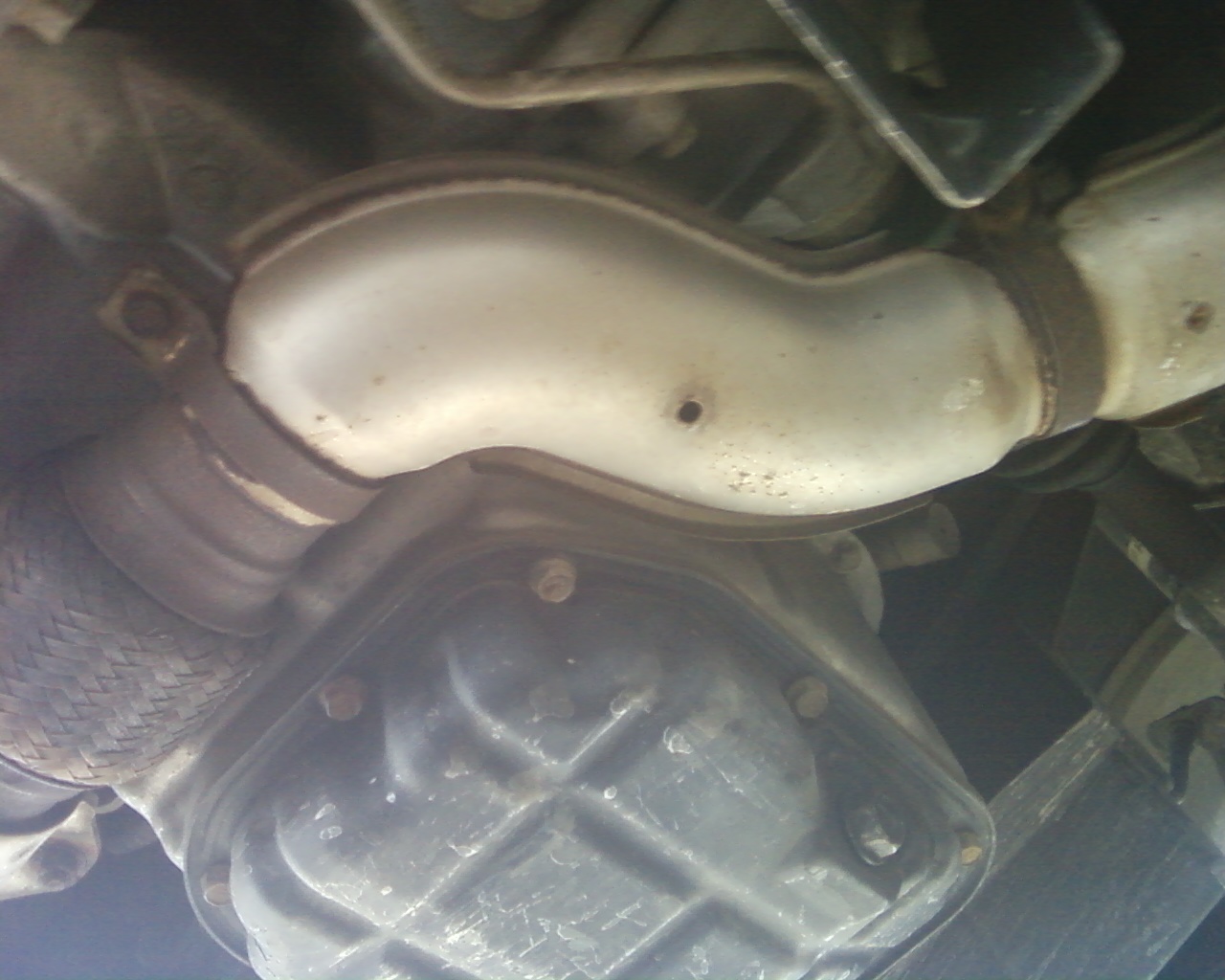

I responded to a similar question about the 'egg smell' from another post. I have it, too. Ours is a 2005 Endeavor with approx 57,000 miles. The smell comes and goes, is very unpredictable, and unfortunately for us, did NOT happen when I shipped it in to the dealer :/ TODAY, our issue is a rattling noise on acceleration. Its as if when you accelerate, and ONLY when you push the gas pedal--- it sounds as if you were blowing across a sheet of paper, or blowing into a fan. That rattling-type noise that would result. Upon inspection at home, all parts on the muffler seem to be intact. It sounds as if it is coming from inside the hood/engine area-- versus outside the car/below the passenger area or tailpipe. I am at a loss on this one. Any ideas would be a great help. Thanks!

Have the catalytic converter checked. Rotten egg smell are most likely to be from a bad converter and the rattling noise indicates the inner parts have disintegrated.
Use a mallet to tap the converter to test for rattling noise.
Sunday, December 26th, 2010 AT 9:59 AM
HOPPY313
  • 8 POSTS
Thanks, KHLow2008. I will have to have the cat converter checked now. At least I know Im not going crazy telling the dealer something that wouldnt happen when I brought it in last time. Unfortunately, my warranty is now up. It wasnt back then. I dont know how theyre going to deal with this one. :/ I found my rattling noise to be nothing more than a loose/broken off piece of shield/guard- whatever it is technically called. Unfortunately, again, only a dealer can order it around here. So, off I will go. Back to the dealer. :/ Attached is a pic of what shield I am talking about. Thanks :)

That is the heat shield for the exhaust and are quite common for them to cause vibrating noise.
Good luck for your visit to the dealer. Hoep they are able to come up with a good remedy for you.

Thanks, KHLow2008. I did take it to the dealer today. They informed me that Mitsubishi tells them to 'just rip it off'. We'll see how this goes. I go in Thursday. Theyre going to 'look at' my cat converter, but since there is 'no engine light, or codes, we can't do anything for you'. How convenient. But hey, its going to be documented TWICE in my file, so. :/ I got 9 more months of warranty, I found out, so THAT was a nice tidbit of info. It'll be close if I hit the 60000 miles first, or the 5 years. :)
