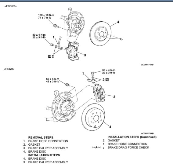

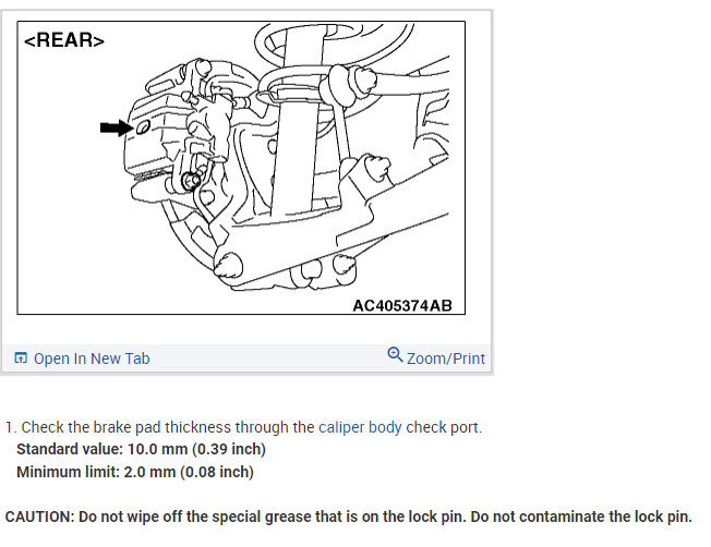

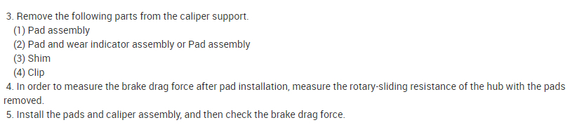

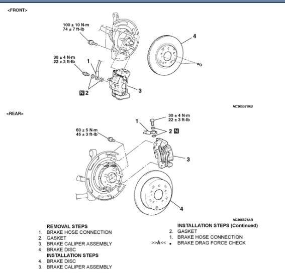

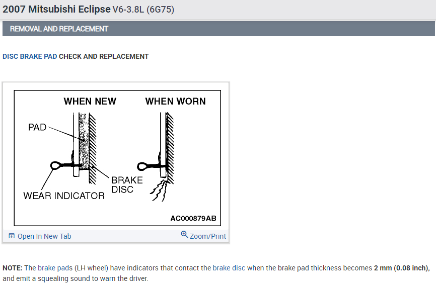

I do I get the front brake rotors off? I need to replace them and the pads.

Hello, I'm Danny.

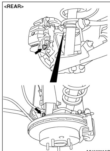

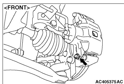

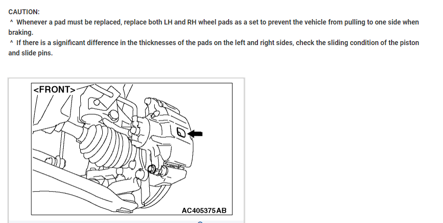

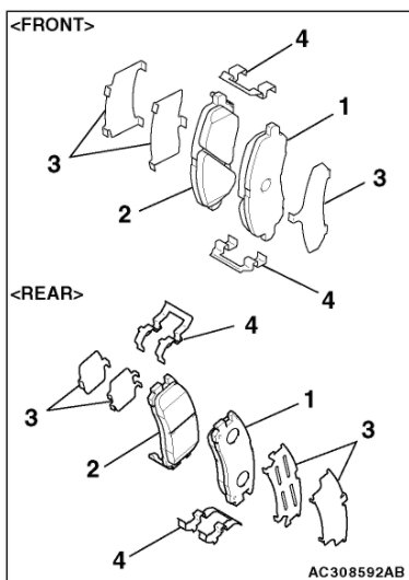

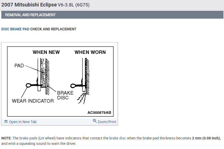

Here is the information you requested. This is a tutorial showing what is involved on how to change front brake pads and brake rotors:
I've attached picture steps below on how to change the front brake pads and rotors on your car. Hope this helps and thanks for using 2CarPros.
