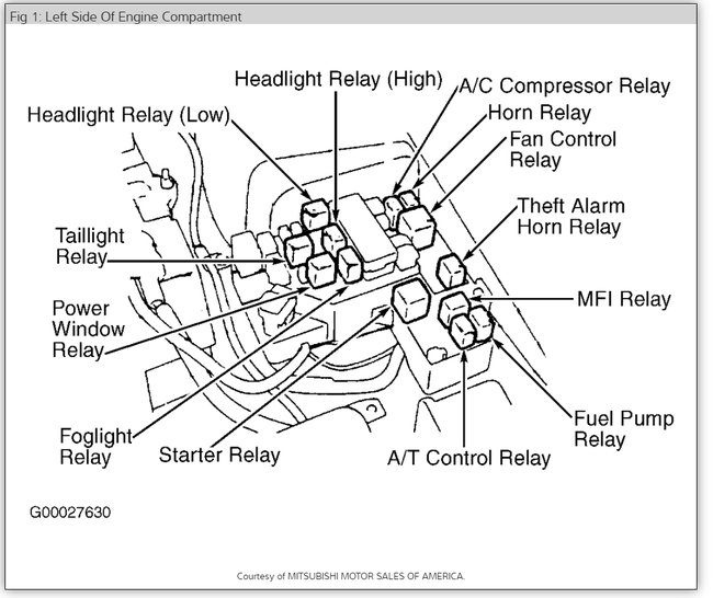

Four cylinder two wheel drive automatic 16,000 miles.
Where is the fuel pump relay located on this vehicle?
May 31, 2009 at 2:43 PM
  • CAR REPAIR CONTRIBUTOR
  • 54,193 POSTS
Hello, The fuel pump relay is located under the hood in the relay center. Here is a guide that will help you do some testing. https://www.2carpros.com/articles/how-to-check-an-electrical-relay-and-wiring-control-circuit
https://images.2carpros.com/forum/automotive_pictures/188069_01eclipserelaybox_1.jpg
Here is the location BELOW Please let us know what happens. Cheers, Ken

EMORENOENRIQUE
My car's engine shut off while I was driving and I tried to turn it on but will not start. It sounds as if the gas is not passing through. I don't know if it's the fuel pump, the relay, please help me find the problem.
Thanks,
Enrique
Nov 17, 2017 at 6:13 PM (Merged)
SATURNTECH9
  • 30,869 POSTS
Do you have a multimeter to do some testing?If so we can see if there is power and ground going to the fuel pump.

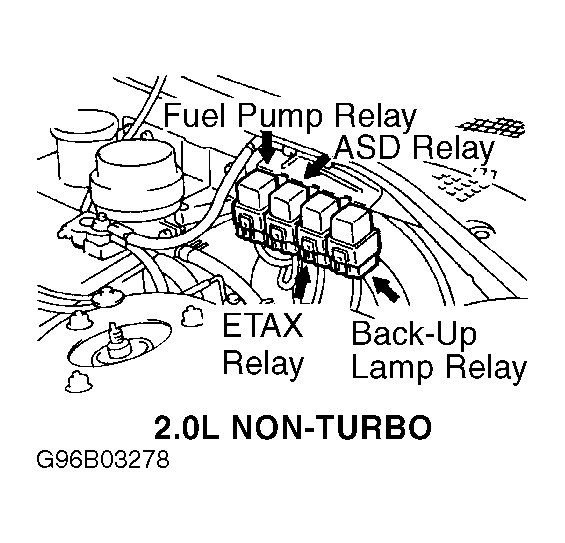

RONNY MARSDEN
I looking for a diagram for where to remove and install fuel pump relay (none turbo).
HARRY P
  • 2,292 POSTS
This is under the hood, drivers side if I am not mistaken.
RONNY MARSDEN
Mine only had two in that same area it sure help after seeing three other diagrams. so I picked the left one our if the two and it works now. thank you
