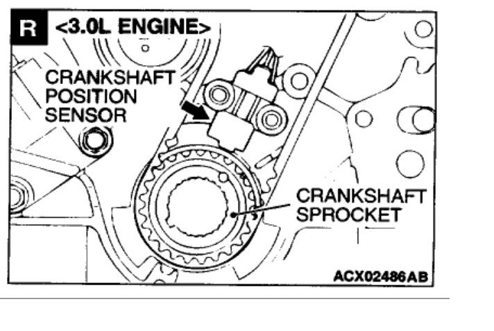

I am replacing a crankshaft position sensor and would like to know where it is located on a 2001 Mitsubishi eclipse 3.0 6 cyl.?
Feb 9, 2008 at 9:37 AM
  • CAR REPAIR CONTRIBUTOR
  • 54,415 POSTS

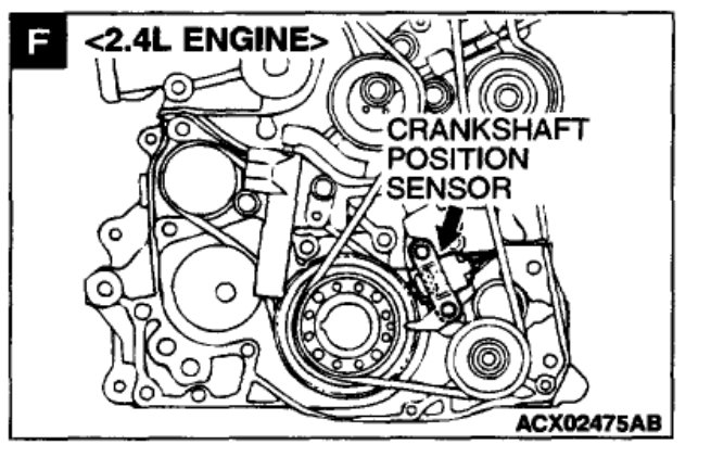

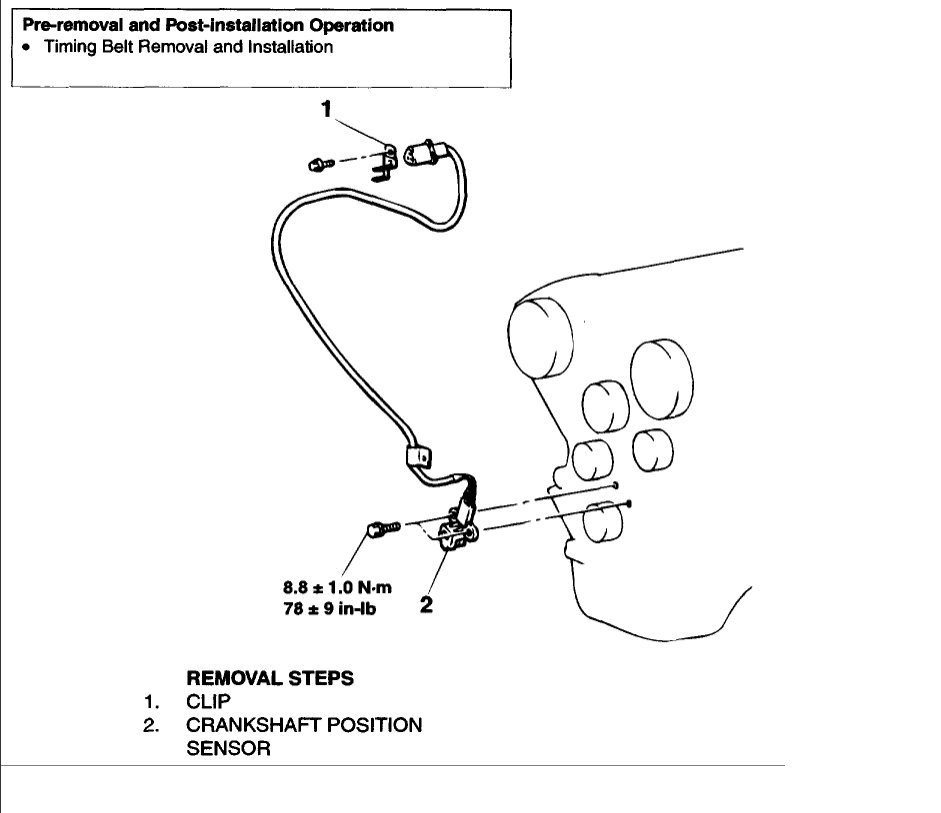

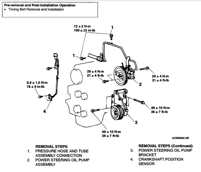

The crankshaft sensor for this car both 4 and 6 cylinder engines is in the front of the engine by the bottom timing belt gear.
Here is a guide on what you are in for when doing the job.
Here are some diagrams for both 4 and 6 cylinder engines. (below)
