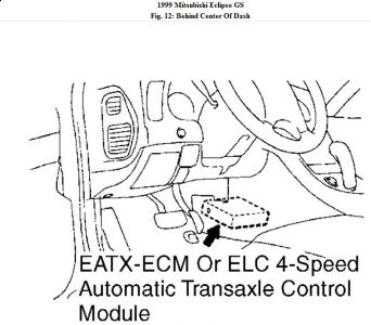

Well, thank you for all that information. But now I am wondering what the TCM is? Is that the Trans-axle control module or the transmission control module? Where is it located and is it a pretty easy fix? Do you want to come and fix my car? LOL

Sorry, I am too far away to be able to perform the repair for you.
TCM = Transmission control module or trans-axle control module.
It is located behind center of dash and removal is not really difficult. Removing the underdash cover would allow you to see the TCM. It is bolted on one side and slotted in at the other.
https://www.2carpros.com/forum/automotive_pictures/192750_TCM99EclipseFig12_1.jpg
