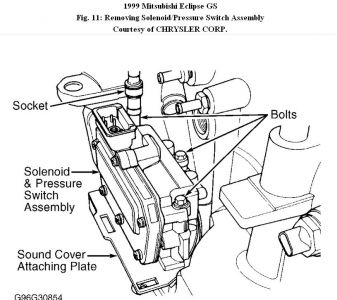

where is the shift solenoid located and how do u change it?

Hi taynlake143, The shift solenoids are as shown in the following post. https://www.2carpros.com/forum/1995-mitsubishi-eclipse-help-vt511996.html SOLENOID/PRESSURE SWITCH ASSEMBLY Removal & Installation NOTE: Do not use solvents or petroleum based cleaners on sound cover. Solvents may deteriorate sound cover or electrical components. 1. Disconnect input speed sensor connector. Remove input speed sensor. Disconnect solenoid/pressure switch assembly harness connector. Remove sound cover from solenoid/pressure switch assembly. 2. Remove 3 solenoid/pressure switch assembly retaining bolts. See Fig. 11 . Remove sound cover attaching plate and gaskets. To install, reverse removal procedure. Before installing sound cover, clean sound cover and sound cover-to-transaxle mating surface. 3. Apply a bead of RTV sealant to sound cover-to-transaxle mating surface and install sound cover. Failure to apply sealant will cause a racheting noise from sound cover vibration.
https://images.2carpros.com/forum/automotive_pictures/192750_ShiftSolenoidRemovalEclipse98Fig11_1.jpg
