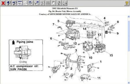

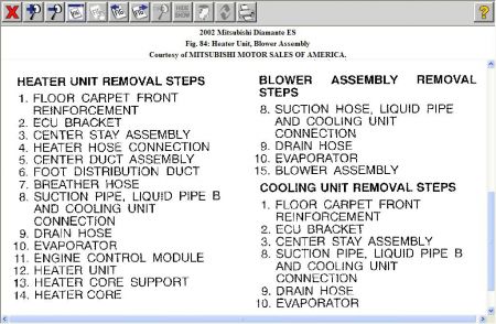

can you tell me the steps replacing the heater core and email a diagram. please email it to kyshamman@aol.com. please send any other information that you think will be necessary

Hi areg1450, HEATER UNIT, HEATER CORE, BLOWER ASSEMBLY AND EVAPORATOR WARNING: Vehicles are equipped with air bag supplemental restraint system. Before attempting any repairs involving steering column, instrument panel or related components, see SERVICE PRECAUTIONS and DISABLING & ACTIVATING AIR BAG SYSTEM in appropriate AIR BAG RESTRAINT SYSTEMS article. PRE-REMOVAL OPERATION Drain Coolant  Instrument Panel and Floor Console Box Removal. Air Cleaner Cover and Intake Hose Removal Refrigerant Discharging. POST-INSTALLATION OPERATION Instrument Panel Installation. Refilling Coolant Refrigerant Charging. Air Cleaner Cover and Intake Hose Installation
https://images.2carpros.com/forum/automotive_pictures/192750_HeaterCore02Diamante01a_1.jpg
https://images.2carpros.com/forum/automotive_pictures/192750_HeaterCore02Diamante01b_1.jpg
