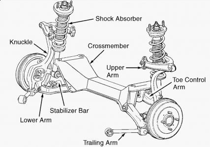

I am not sure which bushing would cost 1800.00! Bushings are simple rubber donuts, with a metal tube thru them, they only cost under 20.00, so find out if they mean installed, some are hard to remove, because of what needs to be taken apart.
https://www.2carpros.com/forum/automotive_pictures/62217_Rear_Susp_1.jpg
The other problem is a Mitsubishi with 200,000 + miles, how much longer can it go? Have the entire undercarriage inspected for rust, I have seen people pour money into unibody cars only to find out it needs a junkyard anyway!

Thanks so much. The diagram really helps. Nope, they told me $1800 just for the part. I told them to FORGET it! You are right, I love this car, but it's not worth putting that much money into.

If it sags in the rear, the coil springs are to blame, but with 100,000 miles and a wobble to go with it, change out the struts at the same time, although I suppose it's not impossible to have a bent knuckle, it is VERY unlikely!

As the coil springs sag the wheels tilt in at the top, and replacing the springs and struts will solve that. As I mentioned before, If the car hasn't been in an accident, there is NO reason to believe the knuckles, of spindles got bent. Tilting tires IS a sign of weak suspension parts. Especially the parts mentioned here! REPLACE BOTH. Or you will be wasting your time and money. Springs CONTROL the ride height, the strut only stops the spring from oscillation(car bouncing). If you want to try to get out cheap, try coil spring lifts.
