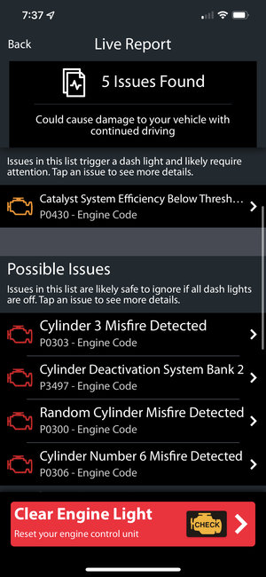

Codes PO303, PO430, P3497, PO300, PO306
JGONZO2398
  • 2008 HONDA ACCORD
  • 3.5L
  • V6
  • 2WD
  • 134,000 MILES

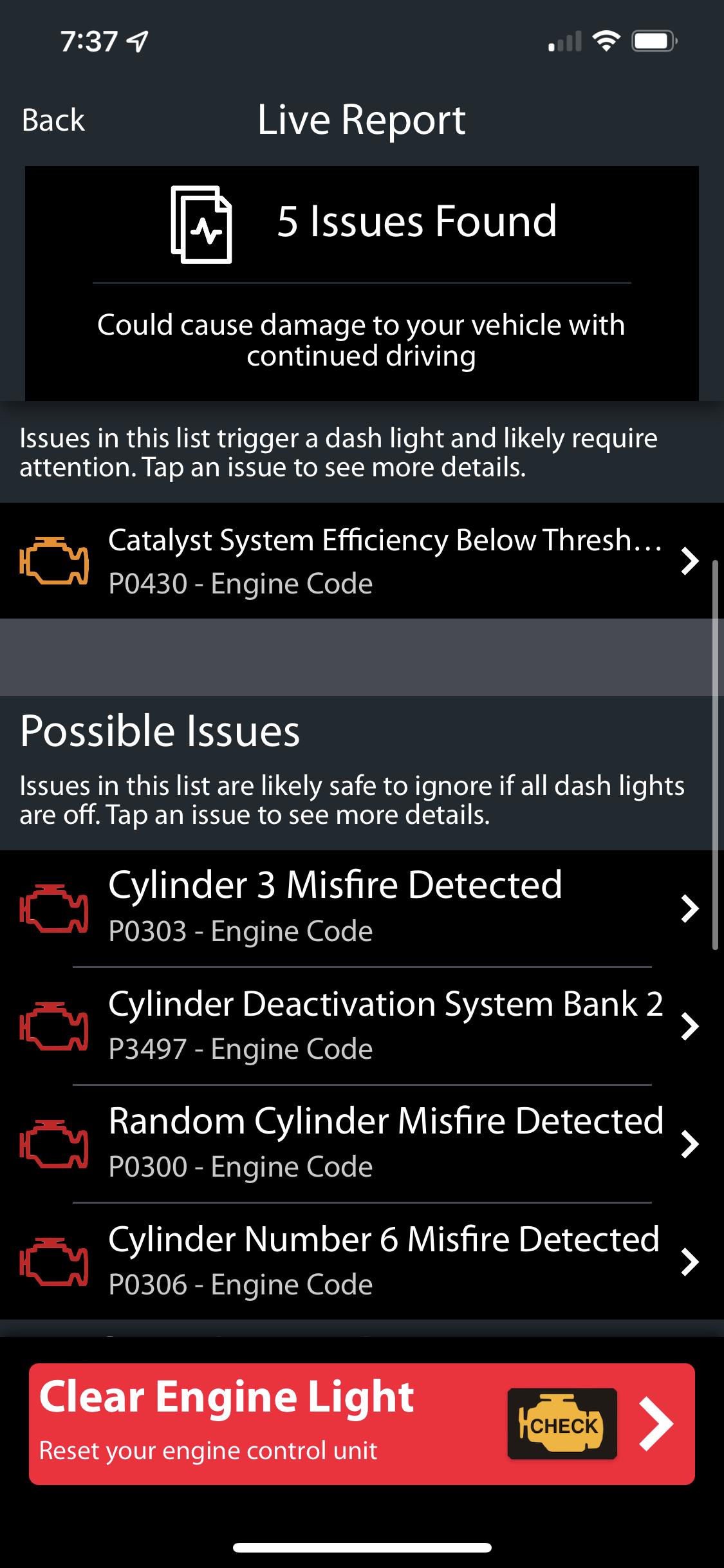

Another problem with my car. Last Friday I was driving from Phoenix to Tucson for work and I noticed that my check engine light started flashing so I panicked. I turned the car off for a bit then turned it on and drove an hour and a half back home with seemingly no issues or check engine light. That day I only had a P0300 code for a cylinder three misfire now I have a total of five codes... I did a spark plug replacement last year in May. Please help!

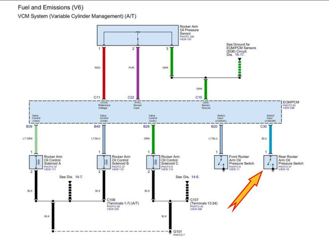

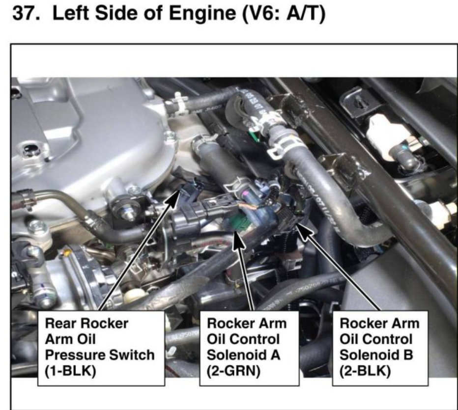

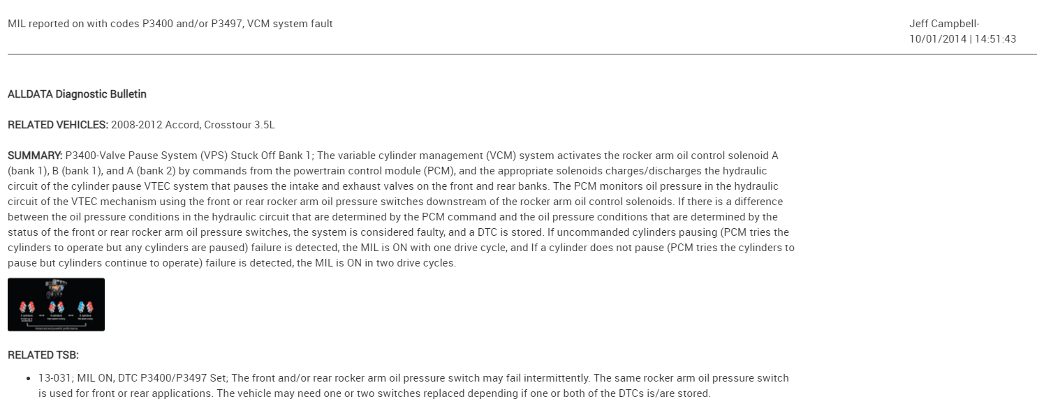

Hello. The code P3497 is causing the other codes. First of all, check the level of the engine oil, make sure it's up to where it should be, the code has to do with the Valve-Pause System (basically cylinder deactivation to save on gas mileage). The ECM (engine computer) can activate certain oil pressure solenoids to close the intake and exhaust valves on one side of the engine. In your case Bank 2, which is why you are getting misfire codes for cylinders 3 and 6 because they are on the same side of the engine. There is a Technical Service Bulletin on this. The ECM monitors the oil pressure to determine which cylinders have been shut down. Most likely you have a failed oil pressure solenoid. You're getting the P0430 because of the misfiring cylinders. Below is the Technical Service Bulletin information.
Since you were able to shut down the car and make it home, it means you are going to have worse problems soon if the issue is not addressed. If you haven't changed your oil or it's low, it can cause this as well. On these systems you must keep up with your oil changes and keep the correct type of oil in the engine as well.
Since you are getting misfire codes, I don't think this is just a failure in the Rocker Arm oil pressure switch. I think it's going to be more of an issue with the Rocker Arm oil control valve or a failed ECM, But the failed control valve is more likely. I experienced this myself on my Honda when I owned it.
But check your oil first, and if it has not been changed in a long time, you can try that first. If the code continues to show up, you'll have to head to the dealership so they can figure out what has failed.

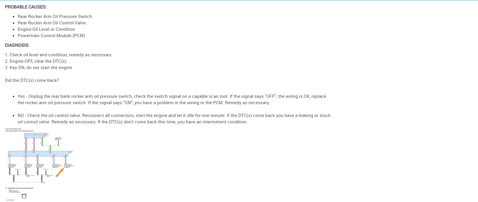

If you have a scan tool that can show you live data, you can try the diagnostics on page 2 below. If not, it will have to diagnosed by someone who can watch live data and see what the ECM is detecting.

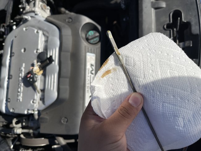

Checked the oil this morning and the dip stick looks a bit dry, barely the tip is catching oil.
Tuesday, May 10th, 2022 AT 7:06 AM
AL514
  • 5,584 POSTS

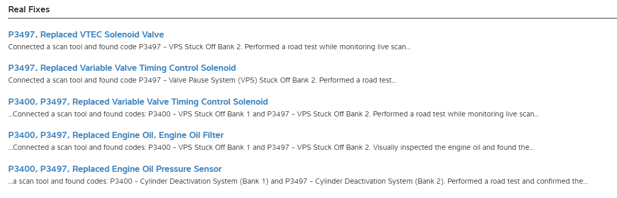

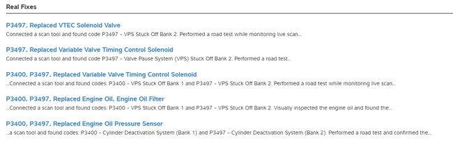

So, you are probably down almost a whole quart of oil. Take a look in your glove box owner's manual to see what kind of oil Honda recommends for your car. Add enough to get it up to the full line, erase the codes and see which ones come back. If there is an issue with a pressure sensor or solenoid a code will come back. It should come back after only one drive I believe. It depends on the code setting criteria for that particular system. Try not to go too far from home, but if you can get to a point where you're at a light cruise, the valve pause (cylinder deactivation) should turn on or attempt to. If the P3497 comes right back, then it needs to have the pressure sensor and the rocker arm oil control solenoid checked. After that's repaired it should take care of the other codes. You just don't want to cause any damage to the catalytic converter (P0430).
I wanted to show you this, here is a small list of "real repairs" due to this code p3497. Just so you can get an idea of what actually happens. The last Honda I had a code for was a similar problem and I diagnosed it as the oil pressure solenoid on the back of the engine. On a road test it was stalling out on the highway doing the same thing yours is probably doing. It's listed here as the VTEC solenoid, some people call it variable valve timing but it's really not what it is. It's a valve closing system to help save on gas.

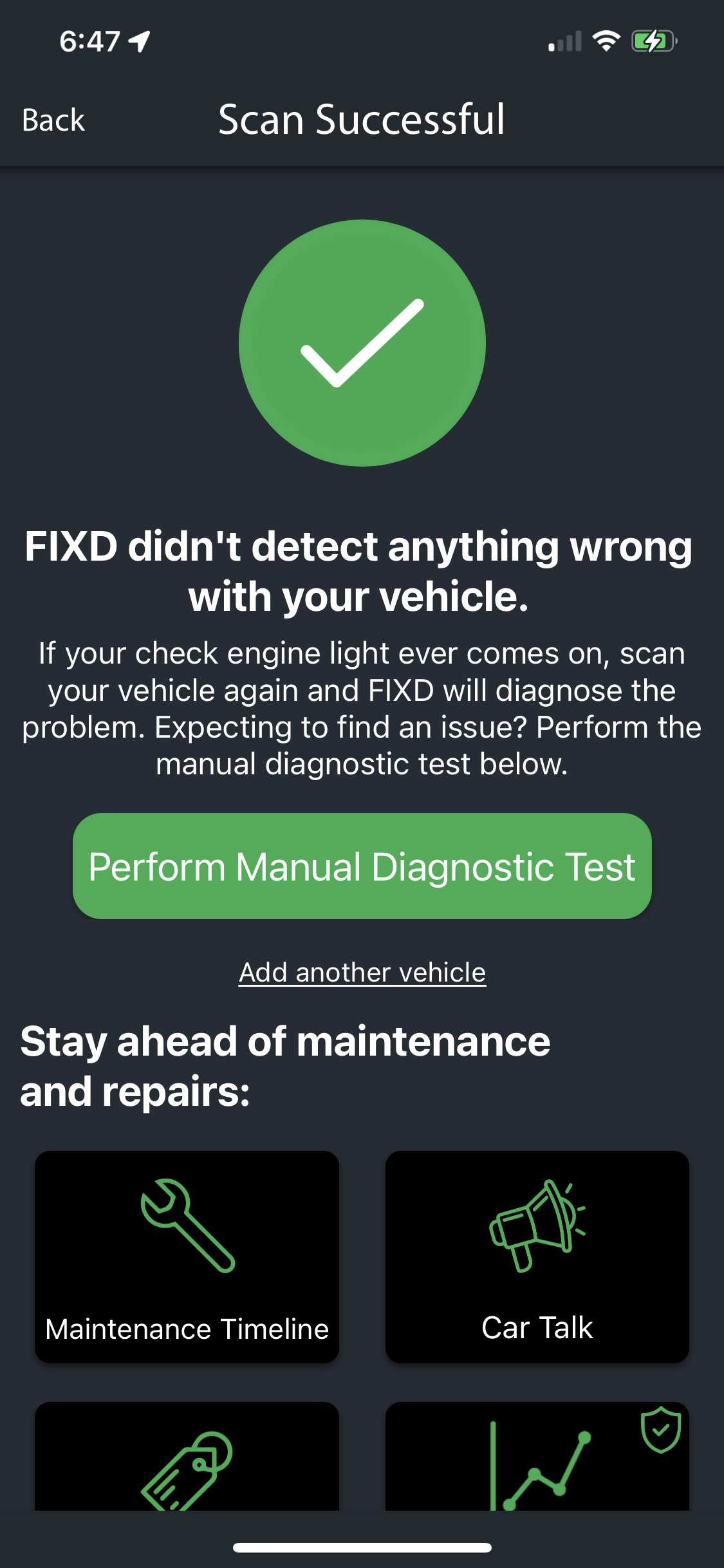

Update: My mechanic was finally able to check out the car this morning, he stated that he didn’t see any abnormal wear on any of the spark plugs (especially cylinder 3 and 6 since those were the ones that had codes) nor any odd wear on the fuel injectors. He swapped the spark plugs from those cylinders then noticed my oil levels were way too low. He said he was surprised I made it back from that hour and a half drive from Tucson. I got fresh new oil put in and a new filter, finally got to drive the car just that I got home, and I feel no issues with it. Scanned it just to be sure and there were no codes found.
