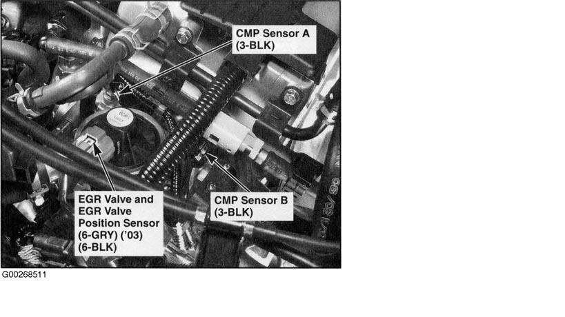

I would like to know the location of the camshaft position sensor for my car listed above it the LX model.

P0341 - Camshaft Position Sensor Circuit Range/Performance
Image (Click to make bigger)
