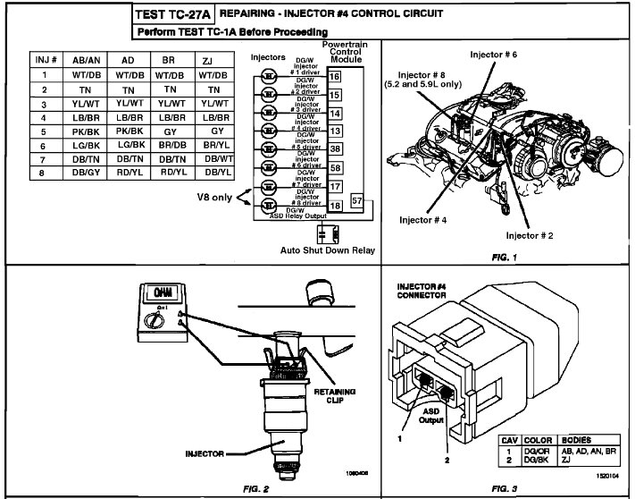

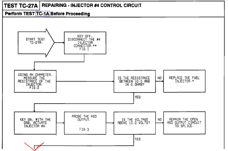

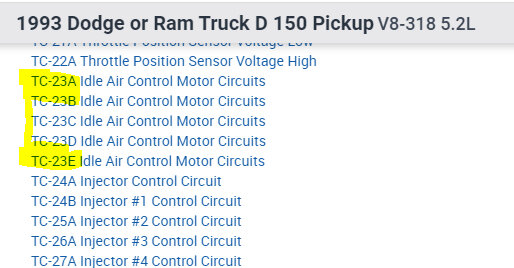

  • 110,194 POSTS
The misfire is likely from the cylinder 4 fuel injector. (Code 27) Code 23 is related to the idle air control. I suspect code 27 is where we need to focus if there is a misfire.
I attached the diagnostics below specific to the code (27). Take a look through them and let me know if you are comfortable performing the tests.
See pics below. Also, look at pic 5. Where did you get the info related to the air temperature sensor? I want to make sure I'm not missing something.
Monday, May 22nd, 2023 AT 7:29 PM

Haynes Manual list of codes from flash of mil.
Tuesday, May 23rd, 2023 AT 6:21 AM

Yes I can do those test.
Tuesday, May 23rd, 2023 AT 2:29 PM
THEROG
  • 17 POSTS
There is power to injector and the ohms are good.
Tuesday, May 23rd, 2023 AT 5:27 PM
THEROG
  • 17 POSTS
Voltage is full strength.
Tuesday, May 23rd, 2023 AT 5:28 PM
  • 110,194 POSTS
Is there an injector pulse if you check for ground via the opposite wire than power?

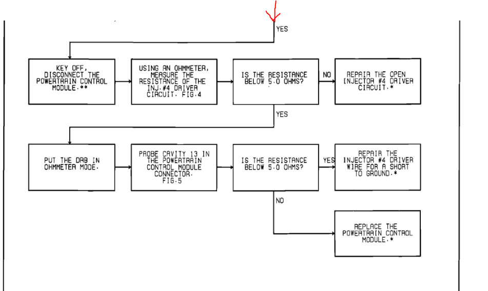

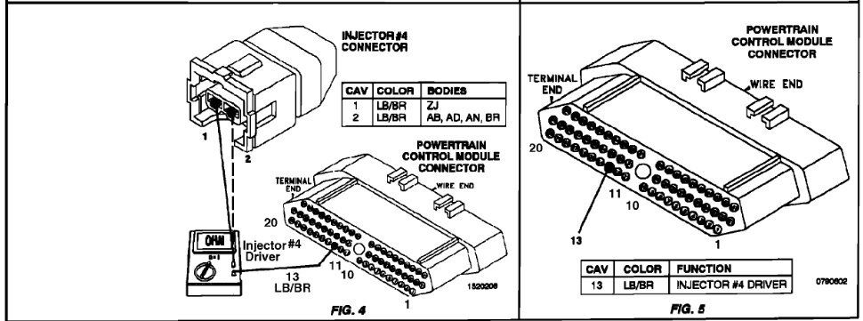

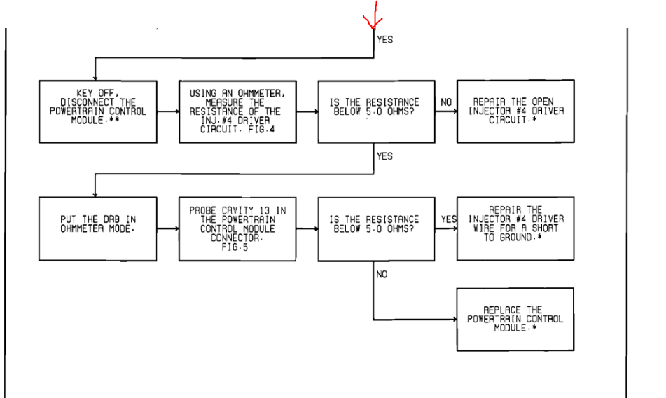

Something is happening with the cylinder 4 injector or circuit. When you did the tests above, did you have the PCM disconnected and checked the resistance in the wiring as indicated? If you did and it was within spec, the PCM itself is suspect.
Wednesday, May 24th, 2023 AT 6:53 PM
THEROG
  • 17 POSTS
No, I didn't disconnect PCM as of unfamiliarity with where to do so, I will readdress it this evening.
Thursday, May 25th, 2023 AT 5:36 AM
  • 110,194 POSTS
Let me know what you find. If it is connected, that could skew the results.
