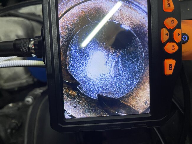

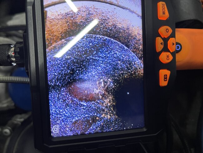

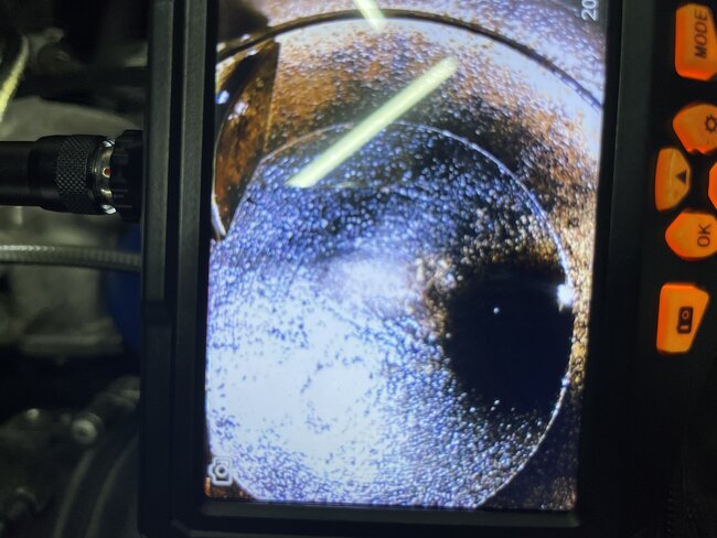

I took a few pictures, does this look like a bent valve or is this normal? Not sure if the cylinders usually have groves on these engines.
Tuesday, October 31st, 2023 AT 8:14 AM
  • 110,192 POSTS
Are the pics you attached all from the same cylinder? I do see marks in picture number two, but pics 1 and 3 don't appear to have the same marks. Also, if there was interference between the valves and pistons, you would know. The pistons would have a clean mark where they touched.
The idea that you may have a bent valve really isn't shown in these pics. Remember, since you have 30 psi compression, which indicates there isn't a bent/stuck open valve. Based on that information, I would suspect something is preventing one of the valves from fully closing.

BHAMDOC1973
  • 2,018 POSTS
Yes, all from same piston 3, one was a side picture to show valve. Strange problem to tackle.
Tuesday, October 31st, 2023 AT 6:34 PM
  • 110,192 POSTS
Is it pic 1 that shows the valves? If so, they don't look seated properly. I may be wrong because it's difficult to tell in a picture, but is what I see.
Tuesday, October 31st, 2023 AT 7:16 PM
BHAMDOC1973
  • 2,018 POSTS
Yes, that's what I am seeing. Do exhaust valves usually suffer from carbon build up as well?

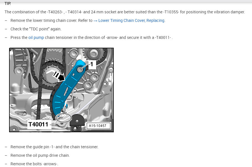

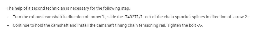

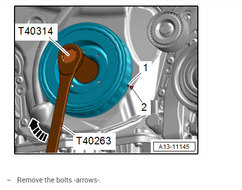

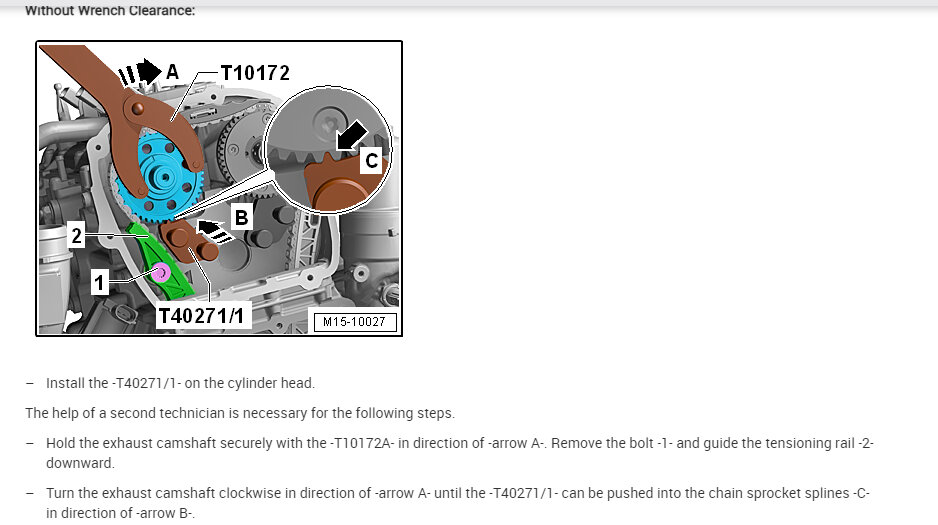

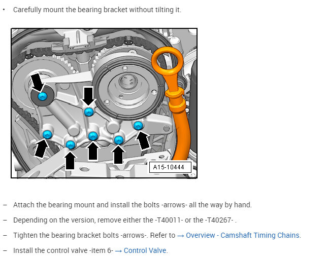

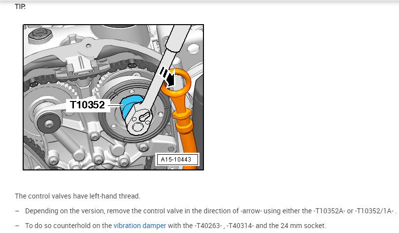

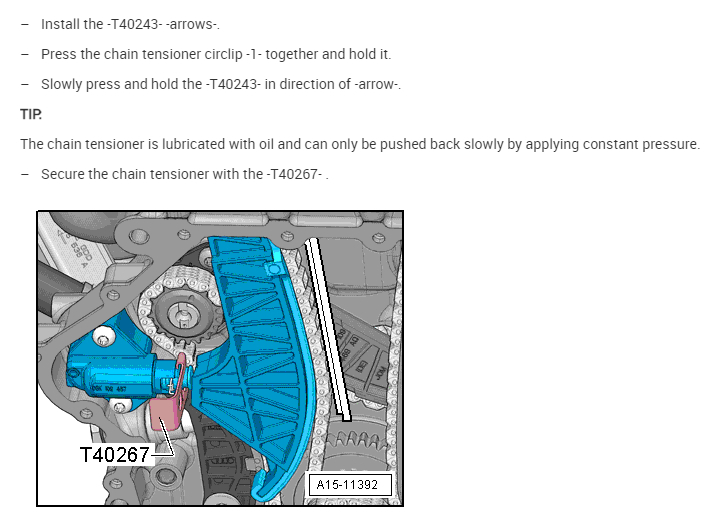

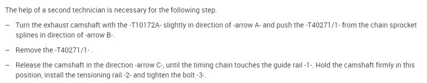

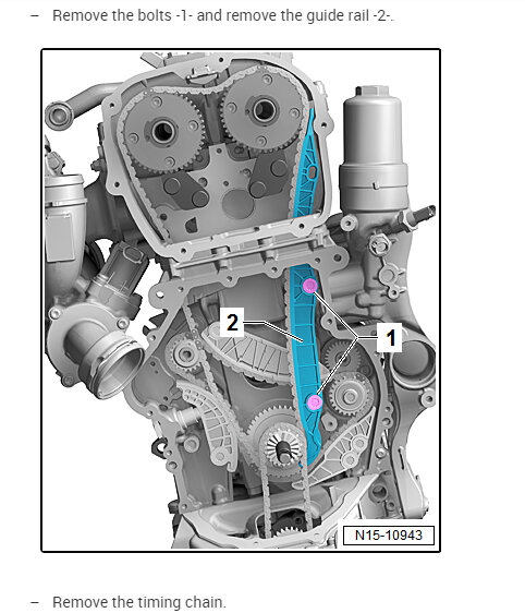

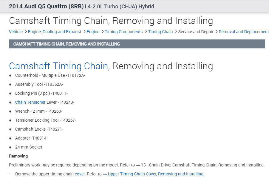

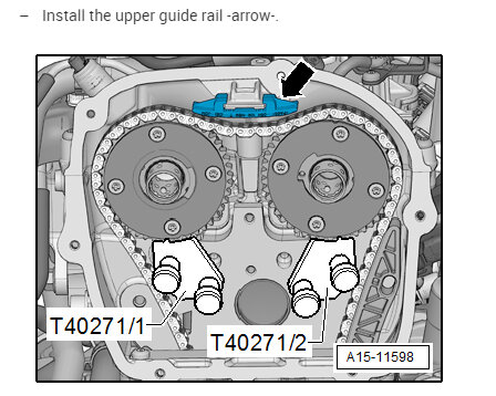

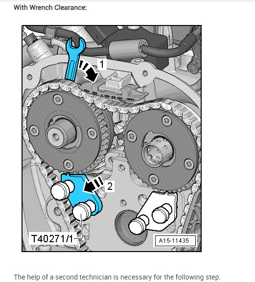

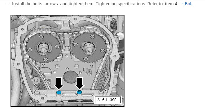

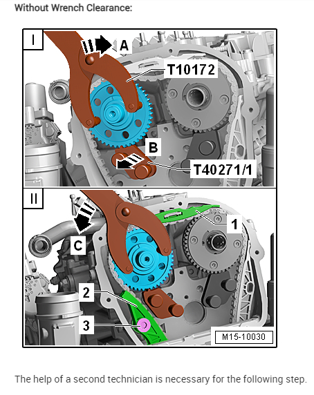

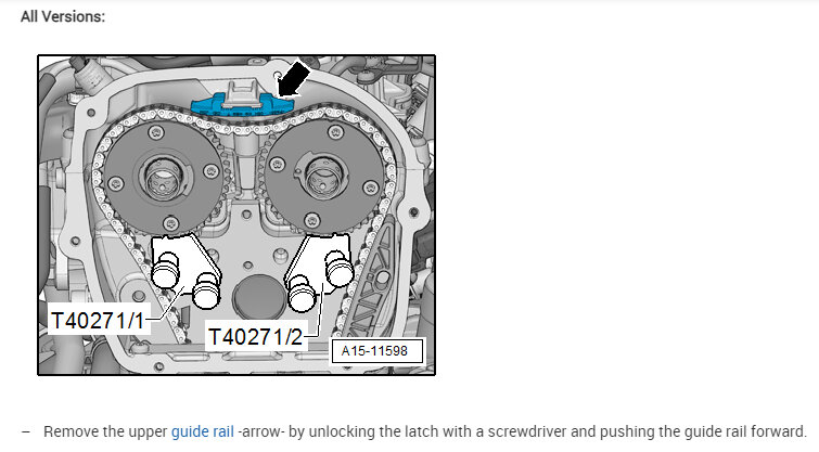

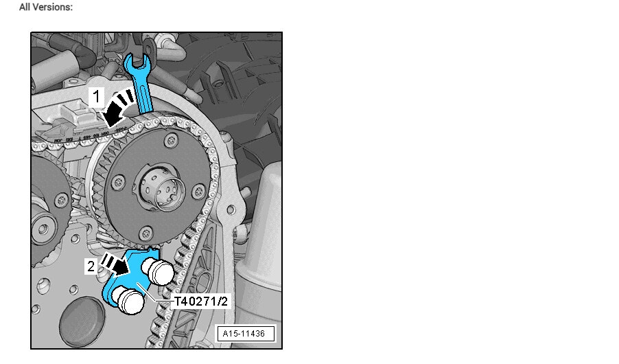

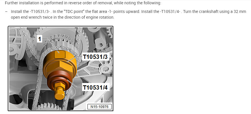

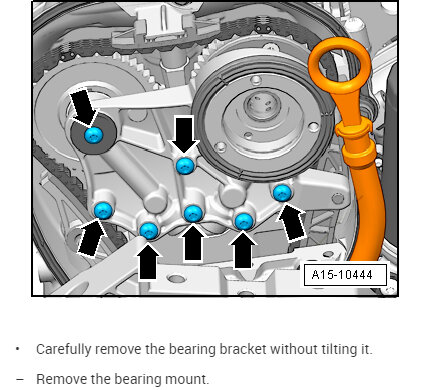

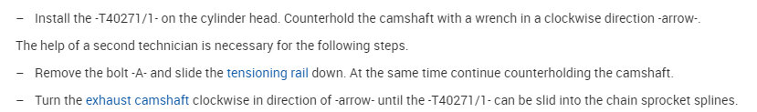

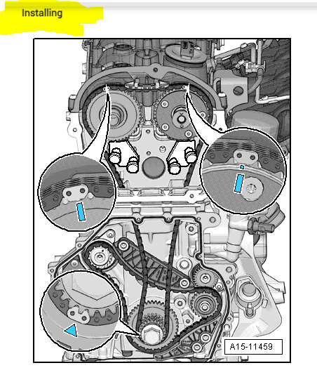

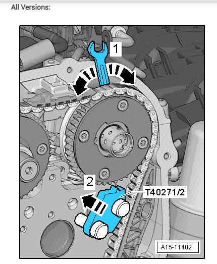

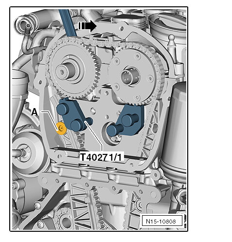

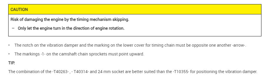

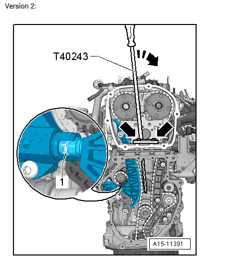

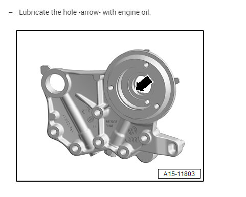

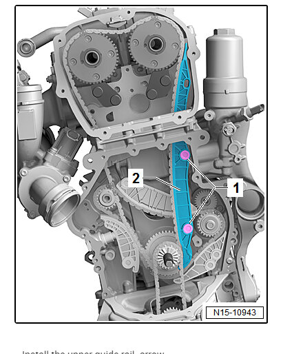

The only thing that scares me when removing the head is the chain. I don't want to deal with timing as I know I am not so good at it. So, I don't want to remove the chain completely but rather just hang it on each side. Also, I see some people remove the turbo aside some don't so I don't know which is easier in this case, whether to leave it on car or remove it with the cylinder head.
Wednesday, November 1st, 2023 AT 6:52 AM

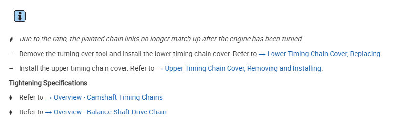

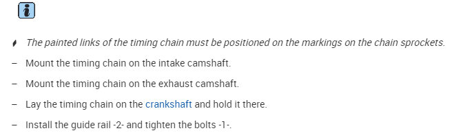

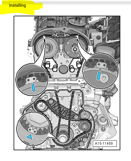

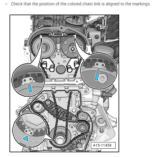

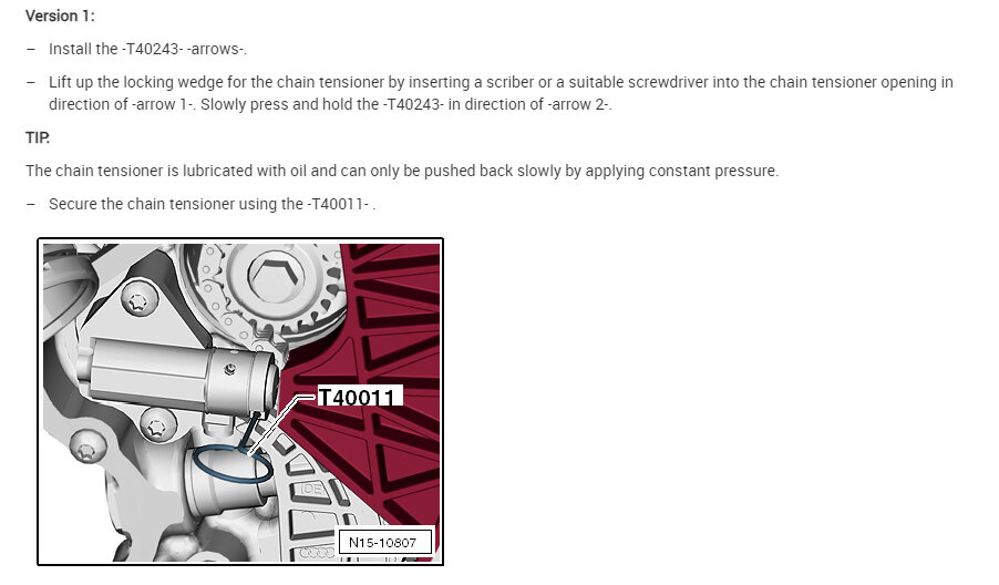

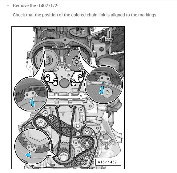

  • 110,192 POSTS
Hi, 43
Either valve can have a carbon issue. If you check other cylinders, do they look the same?

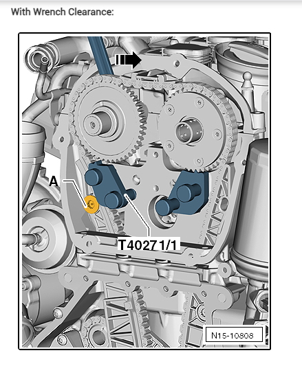

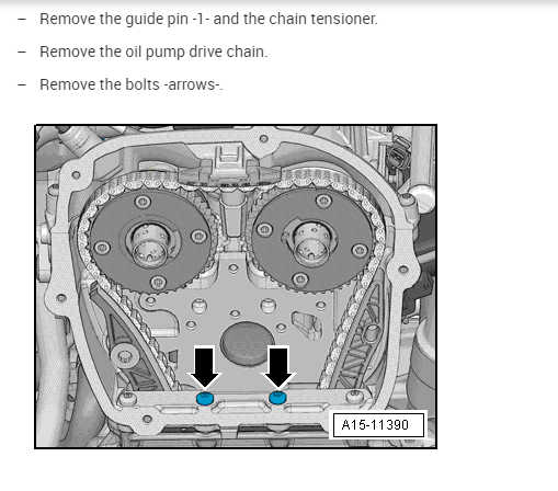

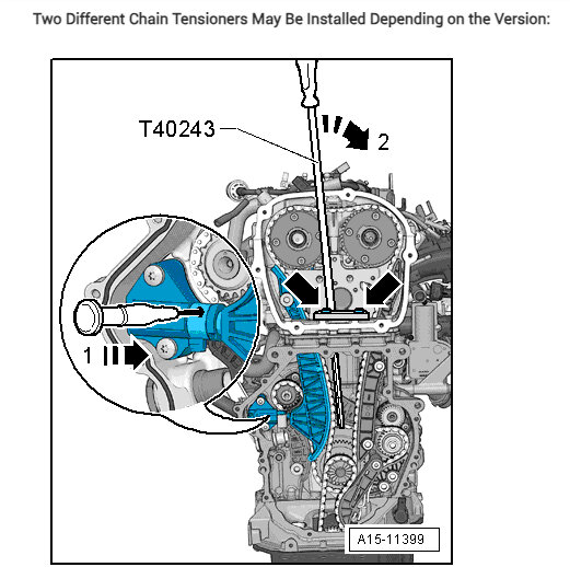

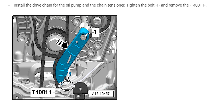

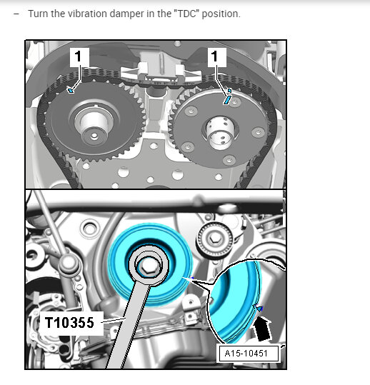

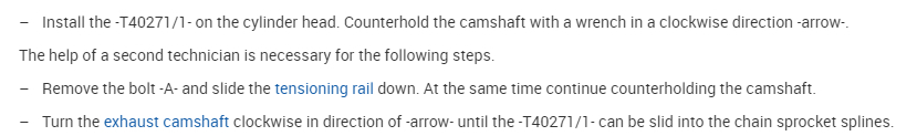

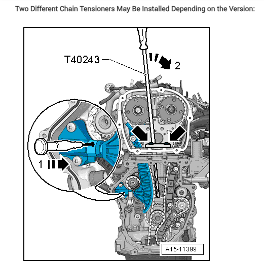

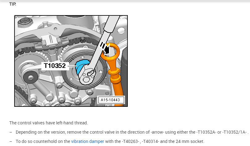

As far as the timing is concerned, I totally understand. This vehicle will require special tooling to hold the cams in place. I attached the directions for camshaft timing chain removal and installation so you can see what needs to be done.
Let me know if this helps.
Wednesday, November 1st, 2023 AT 6:54 PM
BHAMDOC1973
  • 2,018 POSTS
Thanks. All valves had build up which I walnut blasted. Still same exact compression of 30 on that cylinder. No knocking, no timing codes. Ya the chain is scary, I have seen people remove the sprockets and hood the chain to each side tight till done, but not sure if it's doable. One mistake and it's done. I have all of these tools pretty much. Not sure if the issue could be on the exhaust side or if build up can happen there like it does on intake side.
Wednesday, November 1st, 2023 AT 7:16 PM

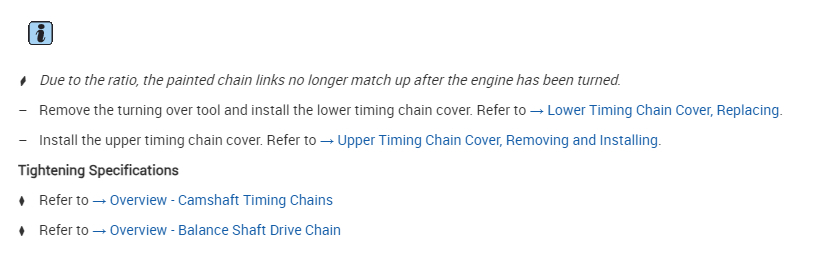

  • 110,192 POSTS
It could be either side. If you decide to remove the head, let me know. I'll try my best to help from here. Also, as long as the colored links on the chain are aligned with the marks, it will be in time. Once reassembled, you can rotate it by hand to make sure there is no interference.
