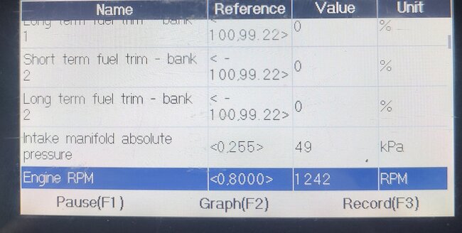

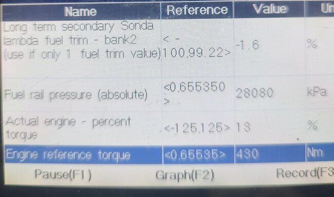

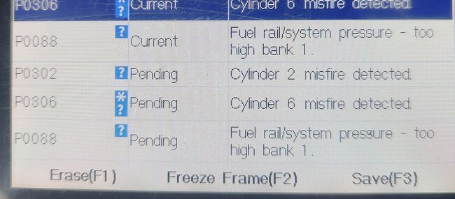

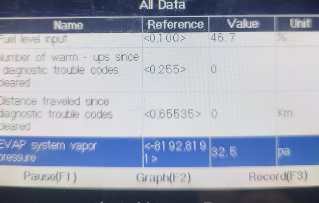

New scan. Not sure exactly what I was looking for so I'm sending some screen shots. I have a few more readings if these aren't it. 2 current codes. #6 misfire, which would be that bad coil and P0088.
Monday, December 25th, 2023 AT 7:19 AM
CANNON1349
  • 913 POSTS
Your fuel rail pressure is reading at 28,080 kPA which = 4,072 PSI. This is absolutely crazy to be at idle! If this is true, I would replace the high-pressure fuel pump. Does your scan tool show a reference voltage for that fuel pressure sensor? It should vary around 5v.

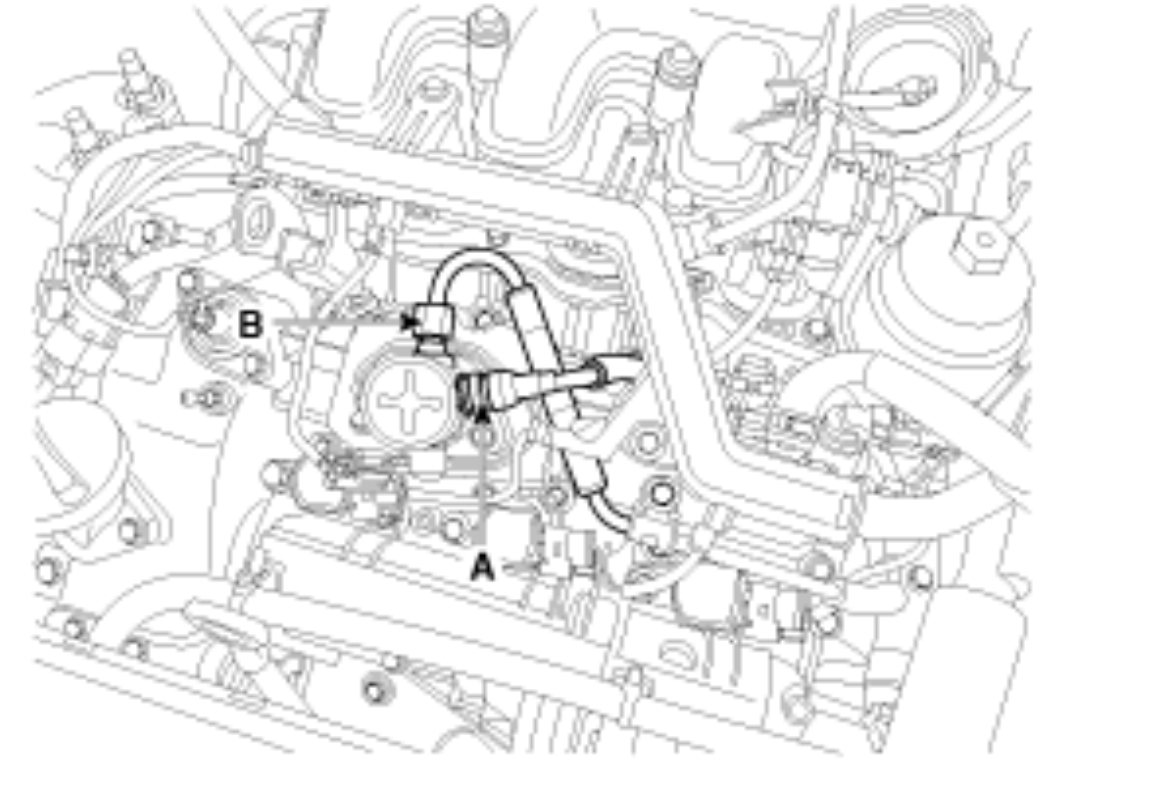

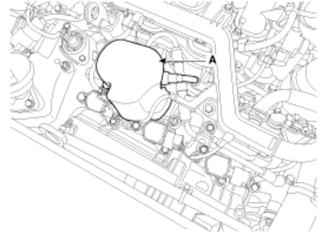

3. Remove the high-pressure fuel pump foam (A).
(SEE IMAGE 1)

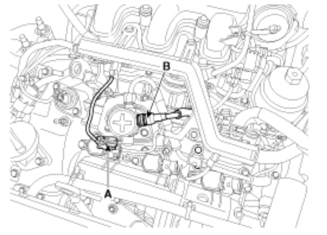

4. Disconnect the fuel pressure control valve connector (A) and fuel feed tube quick connector (B).
(SEE IMAGE 2)

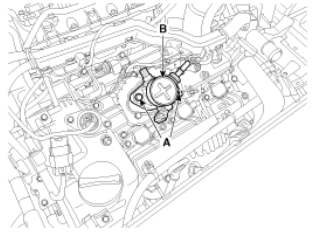

7. Remove the mounting bolts (A), and then remove the high-pressure fuel pump (B) from the cylinder head assembly
High pressure fuel pump mounting bolt:
12.8 - 14.7 N m (1.3 - 1.5 kgf m, 9.4 - 10.9 lb ft)
8. Unscrew in turns the two bolts in small steps (0.5 turns). When one of the two bolts is fully unscrewed while the other bolt still intact, the housing surface of the cylinder head may be broken due to tension of the pump spring.
(SEE IMAGE 3)

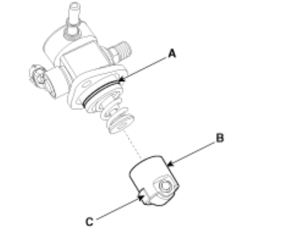

15. Apply engine oil to the O-ring (A) of the high-pressure fuel pump, the roller tappet (B), and the protrusion (C). Also apply engine oil to the groove on the location where the protrusion (C) is installed.
(SEE IMAGE 5)

Scratch that last message. I got all the injectors changed out and it purrs like a kitten. Two of the first injectors were clogged up pretty badly and the rest didn't look good. So, it was worth doing. We are back to what you said. 4 codes after this change. P0088 and misfire on 2 and 6 and random misfires. I backed it out down the long driveway, and it was smooth as can be. Got on the road put it in drive and it started smoothly and stopped at 2,000 RPMs wouldn't go any higher. So, I'm shopping for high pressure fuel pump.
