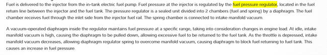

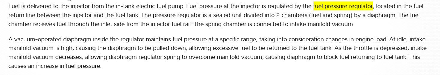

I cant find the check valve for the fuel pressure. I'm looking along the fuel rail but I do not see it.
Monday, October 5th, 2015 AT 1:15 PM
HMAC300
  • 48,601 POSTS
I think you mean regulator see pic it has a vacuum line going to it. Ther eis no pic just explanation of where it is.
