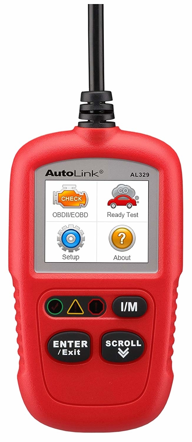

That scan tool might work, never tried one. I have an Autel AL329 that stays in the car just in case I might need it. It seems to work OK on many vehicles. I grabbed it in a walmart while out one day. It is update-able online for free.

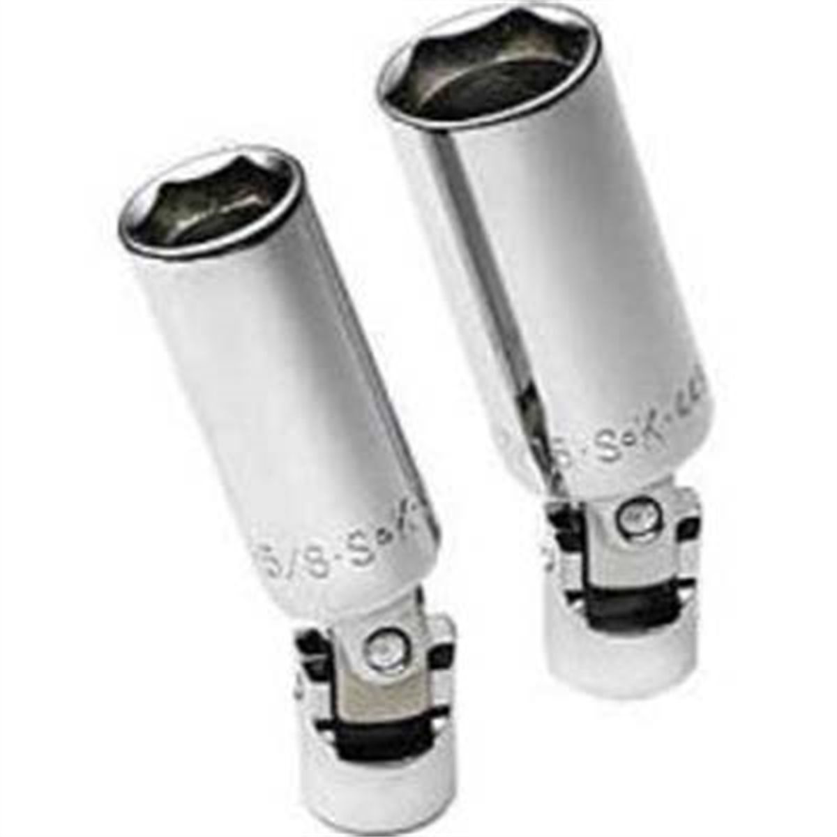

They crack if you get the socket in on an angle, the plugs don't set perfectly straight in the head. I like to use a flex plug socket and not push down on it as it turns.
