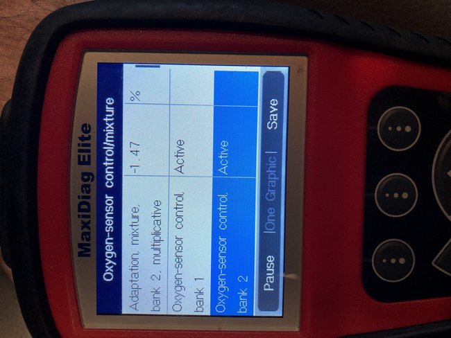

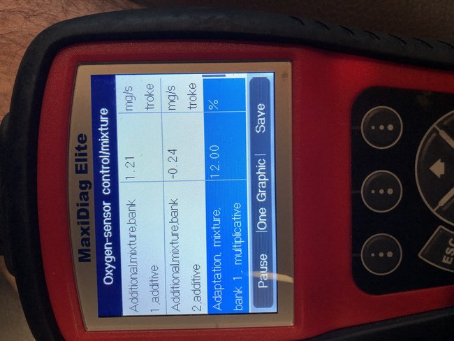

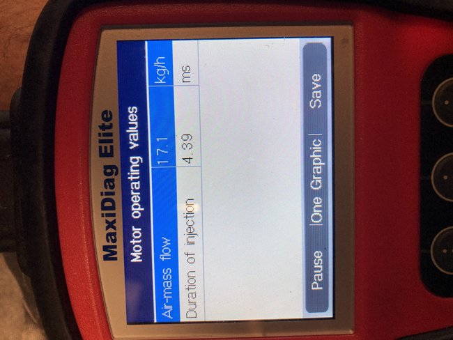

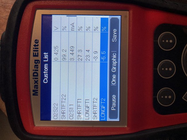

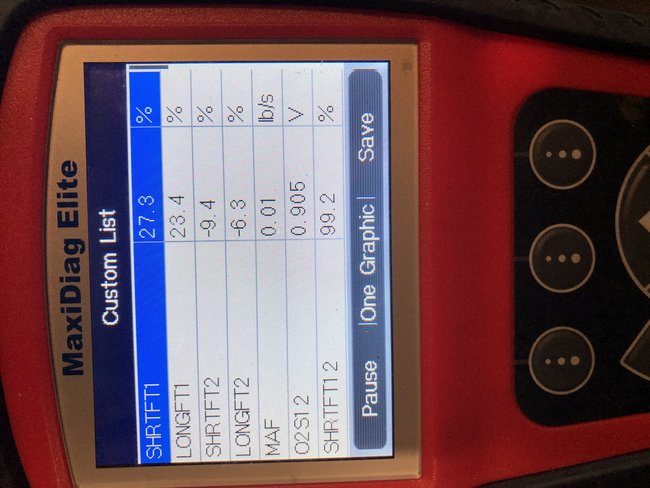

Here are the numbers you requested and more, at optimal engine temperature.
Wednesday, October 30th, 2019 AT 8:47 AM
NASER NASER
  • 836 POSTS

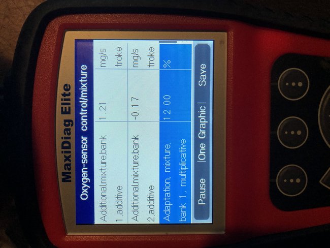

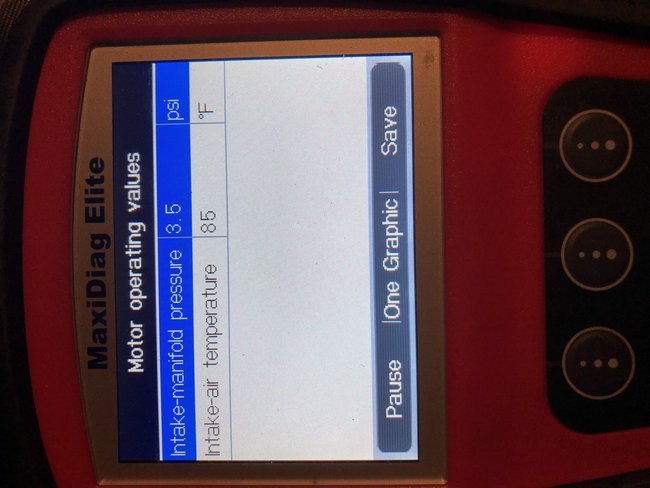

Attached.
Wednesday, October 30th, 2019 AT 8:49 AM
  • 110,192 POSTS
Welcome back:
The computer is trying to adjust bank 1 to compensate for a lean mixture. The STFT should be close to 0 and the positive (high) number indicates it's allowing the injectors to stay open much longer than normal which is most likely the cause of issues on bank 1. Are you certain there are no vacuum leaks or even an exhaust leak pre catalytic converter?

Nothing. If I remove the harness to the MAF sensor I saw a code for it plus one for the intake air temperature sensor, but I don't have one on this engine. Cleaned the MAF and put it back and plugged it. Do these readings look right? The engine is up to normal temperate. Also after clearing the codes I have none now but the oxygen sensor before catalytic converter bank 1 code is present.

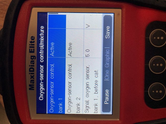

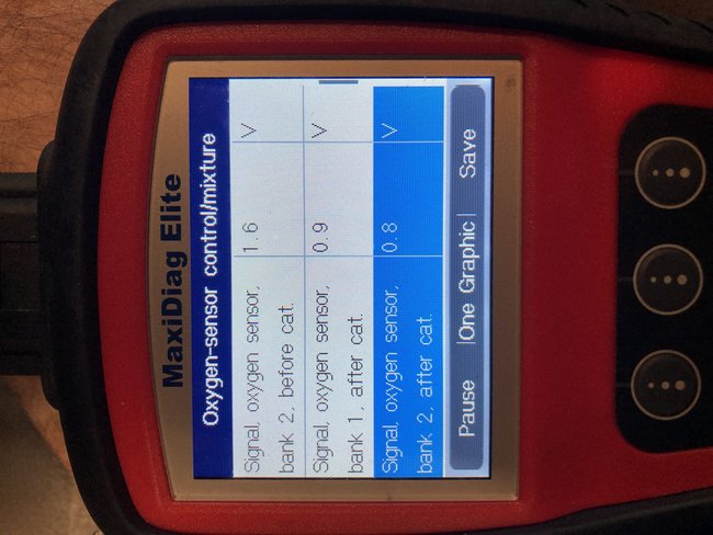

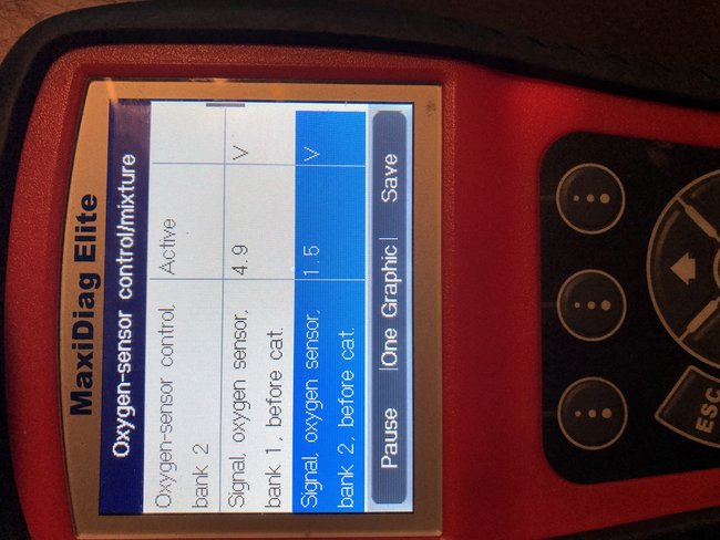

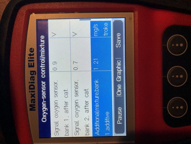

And I just checked the values on the oxygen sensors. Do these look right?
Thursday, October 31st, 2019 AT 7:53 AM
  • 110,192 POSTS
Welcome back:
It is based on how long the vehicle was running. They can go up to about.9v with a rich mixture when cold but should level out to aprox.45v when at operating temp.
So, one of the pics is higher than the other. If that was before warm up, no problem. The other is really close to normal, which should be after warmed up.
I hope this helps.
Thursday, October 31st, 2019 AT 7:40 PM
NASER NASER
  • 836 POSTS
As I indicated the engine was fully warm. I also noticed that one at 4.5v and the graph also shows that it sometimes move and others its solid line.
Friday, November 1st, 2019 AT 4:54 AM
NASER NASER
  • 836 POSTS
Replaced the bank 1 before cat oxygen sensor and now reads 1.3 just like bank 2 before cat, and both after cat reading around.7, so far so good, crossing fingers, if that doesn't fix it I assume this was one of the issues, because the oxygen sensor is real black and was reding 4.5v all along, I just don't know why they reading 1.4 and not in the range of.1-.9 while warm.
