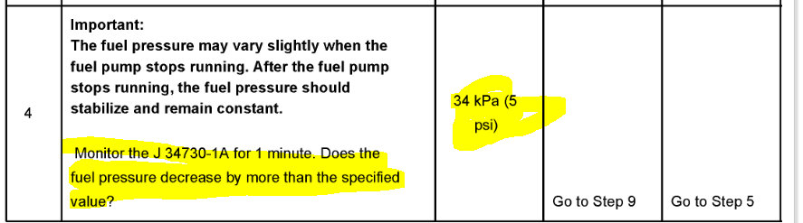

On this vehicle, the upper intake needs to be removed, as you already know. It certainly sounds like a stuck injector.
Rather than taking everything apart, you could get a fuel pressure gauge. Pressurize the system and see if the pressure drops quickly when the pump is off. It should stabilize and remain pressurized for one minute and not drop more than 5 PSI. If it does, you likely have a leaking injector.
Let me know if that helps or if you have other questions.
See pic below.

I tested the fuel pressure and got 48 PSI and holding. Running 45 PSI. No fuel in regulator. I did a snap test with the throttle, and it rose to 50 PSI and then back to 40 PSI and restabilized at 45 PSI. Disconnecting the line to the regulator caused a rise to 50 psi. All appears to be functioning properly, no failed injector. The only thing I see out of place is a line near the driver's side fender that has a quick connect that isn't attached. There is a Schrader valve with a green cap on it. It appears to drop down and head toward the rear of the car. Might have to do with the ABS though I haven't chased it yet? I also checked for vacuum leaks at the intake and found none. Thanks for your assistance, so with it still wet fouling number two where do we go now?

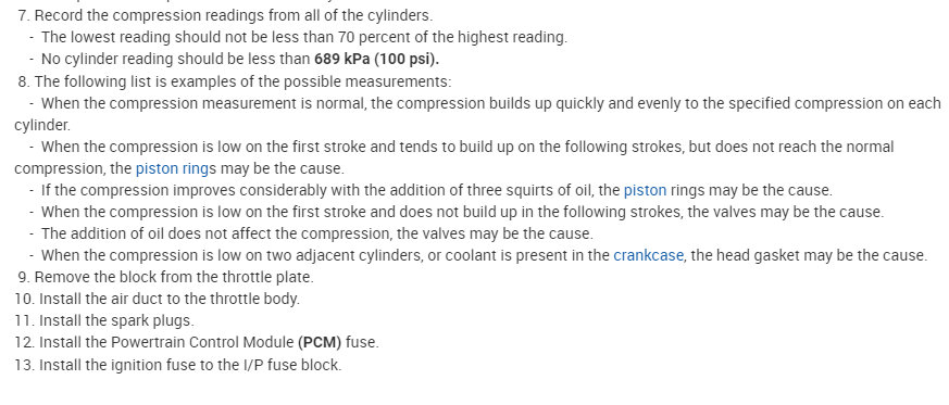

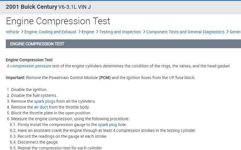

If you have spark and fuel, then we must have a compression issue. I need you to check that next. Here is a link that explains in general how it's done:
I attached the directions below specific to your vehicle. It includes the manufacturer's pressure specifications.
Tuesday, August 2nd, 2022 AT 10:51 PM

Unfortunately, I ran the test cold but here is what I found:
#1 130
#3 135
#5 130
#6 125
#4 105 w/oil 125
#2 75 w/oil 100
Not great looks like a ring issue, what about something like Restore that is supposed to fill the voids? I'm not a fan of additives
You can see I ran #2 last hoping against the odds, but we all knew what was up, lol.
Wednesday, August 3rd, 2022 AT 8:58 AM
  • 110,192 POSTS
That is a good indicator that the rings are worn. It could be a combination of valves or even a gasket, but the idea that it increased 25% with the oil, the rings are an issue.
As far as the restore, I've never used it, but it can't hurt. I'm a lot like you as far as additives are concerned, but considering the circumstances, why not?

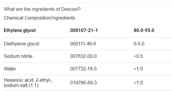

My mistake. No Dex cool. Have to check tomorrow on the rev, Replacing brake lines and fuel line. No pressure for now, bled out.
Friday, August 5th, 2022 AT 9:02 PM
  • 110,192 POSTS
LOL no problem whatsoever. There are too many things to remember.
As far as wax, no it isn't in DexCool. I attached the ingredients below.
See pic below.
Friday, August 5th, 2022 AT 11:18 PM
