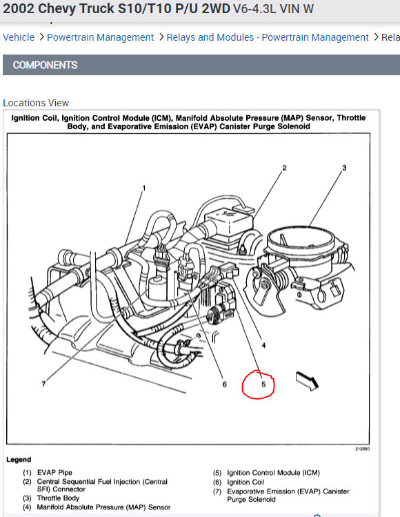

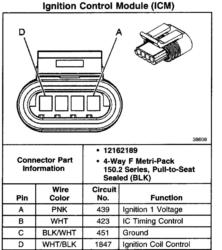

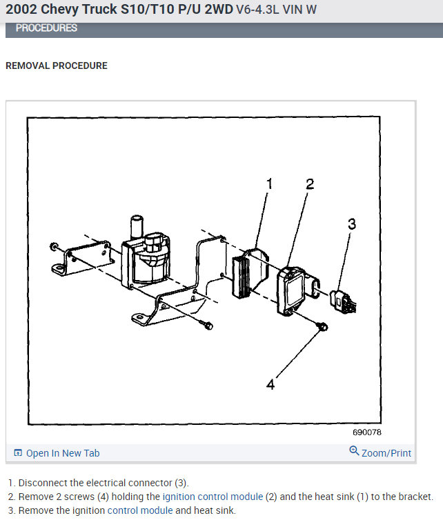

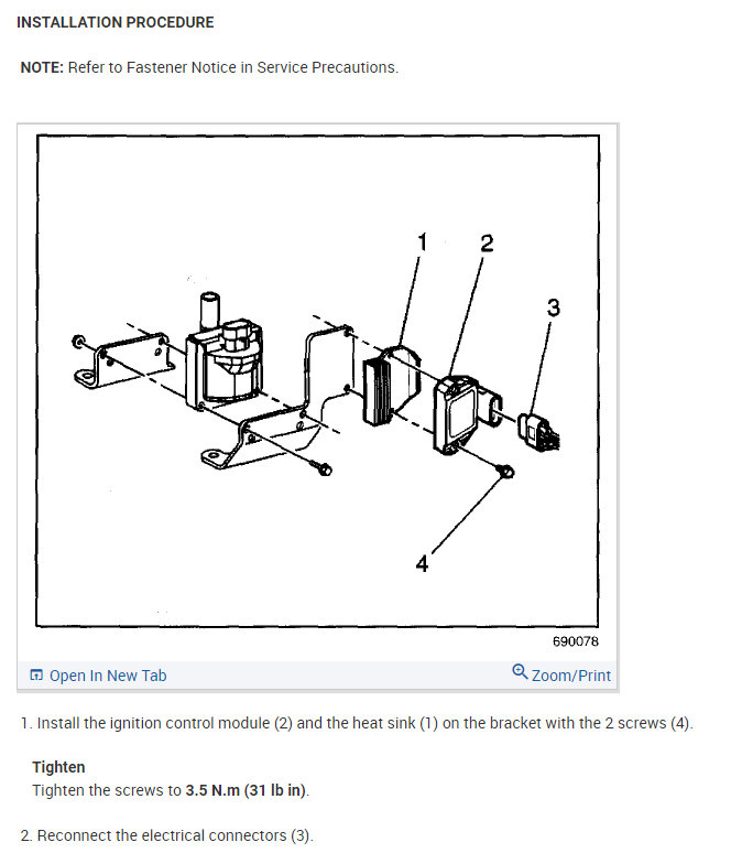

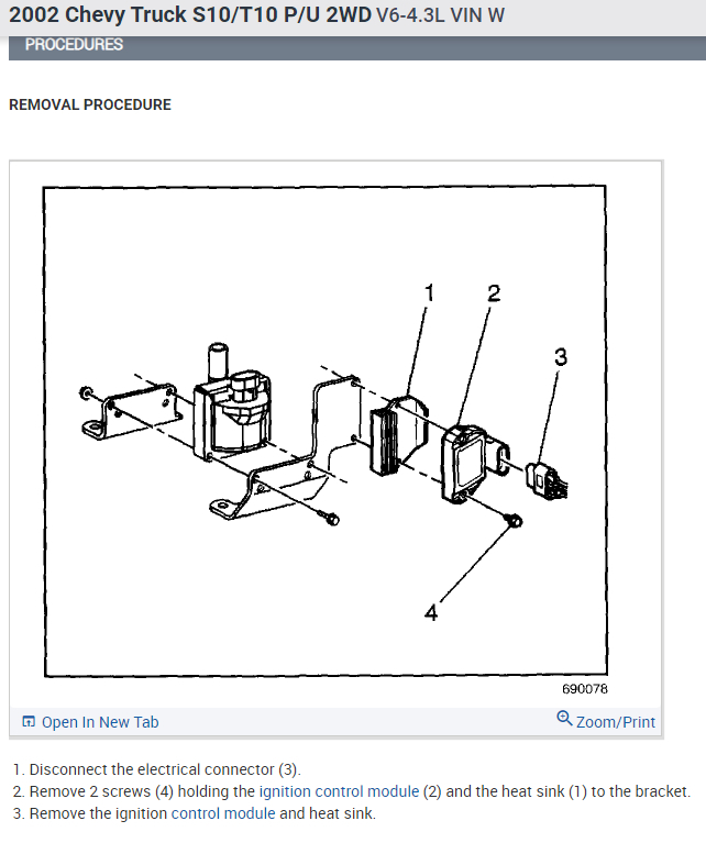

Have you got a chance to check the ignition control module?
The ICM controls the coil and plugs. A bad ICM can produce random misfires.
The ICM can be tested, usually you can take it off and take to your local auto parts store and they will test it for you. This way if it is not faulty you just don't want to replace it.
Let me know what you got.

The random misfire can be triggered by ignition control module. If you have not already might want to get that checked. That module is right next to the coil.
Monday, August 30th, 2021 AT 9:24 AM

Changed ICM still misfires and knocks not saying bad coil but coil is new.
Friday, September 10th, 2021 AT 9:35 AM

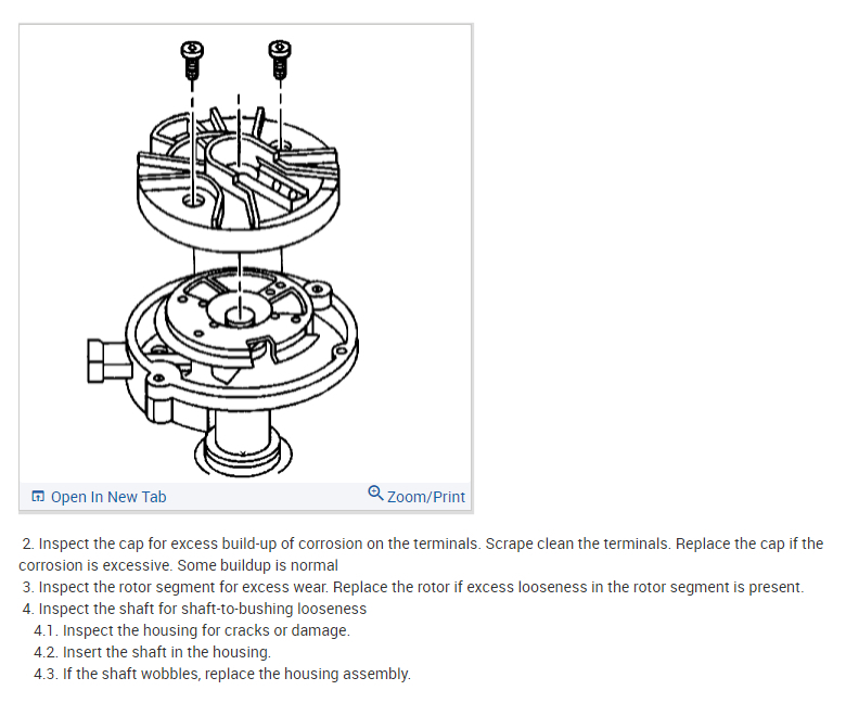

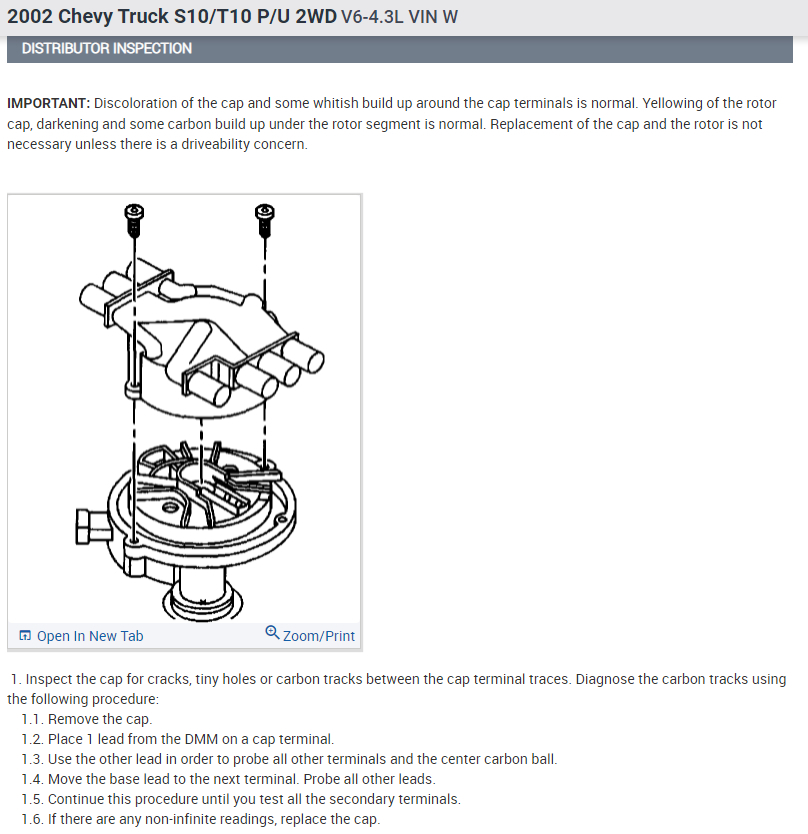

You know the other item could be the distributor itself. Do a thorough inspection of the distributor. See the guide below, it does over the inspection process.

Have you made sure that the distributor does not have any play in it. Loose distributor can give random misfire codes. Other than that it can be the spyder injectors or ECM.
