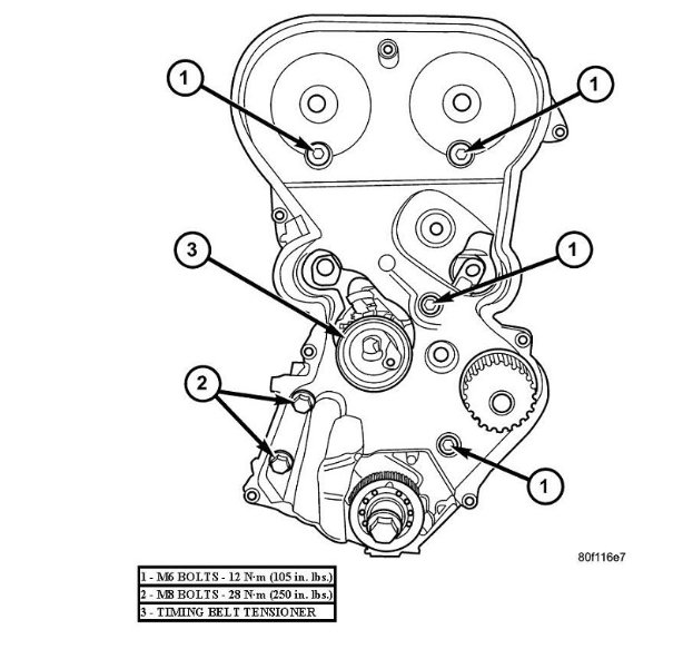

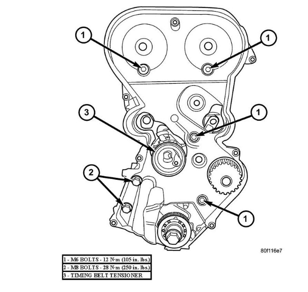

  • 52,797 POSTS
Okay, first, remove the belt from the water pump and alternator and see if it is still there.
If it is gone, it could be the water pump.
If it is still there, it sounds like it could the idler pulley for the timing belt. That is under the front cover of the engine.
Tuesday, January 8th, 2019 AT 11:14 AM
