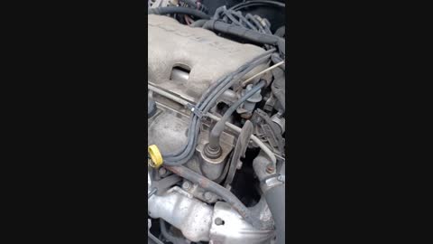

A few months ago, I noticed a metal clanking sound from the engine for a few minutes after the car was turned off. Then just a couple days ago I smelled antifreeze, and the car didn't overheat but went the middle mark on the gauge until I turned the heat on. And loud metal clanking noise lasts longer after being shut off since it's been getting hot. I don't know what email this says to contact me on, but this is the one I have now.

Is it possible for you to record the noise you heard? Also, is the engine coolant in the reservoir full?
I watched the video and there wasn't anything that I saw, but if I could hear it, that would likely help.
Additionally, could you let me know if it is running properly other than the noise or overheating?

It has sound on my end I'll try to send it again.

I took a recording of part of the video and it uploaded but then said "file type not allowed". So, it's very slowly uploading the video again right now. Hope it works this time. And yes, the reservoir was full and no leaks, fans both coming on. Just the metal clanking, smell of antifreeze, and temperature gauge moving past the middle when it usually stays right at.

The only sound I hear is people moving around. Have you checked to make sure the serpentine belt is tight? Have you checked the water pump? Grab on the pulley and see if there is play in the pump shaft.
Let me know. Also, if a belt tensioner failed, it could have made noise and allowed the engine to overheat if the pump wasn't turning too fast.

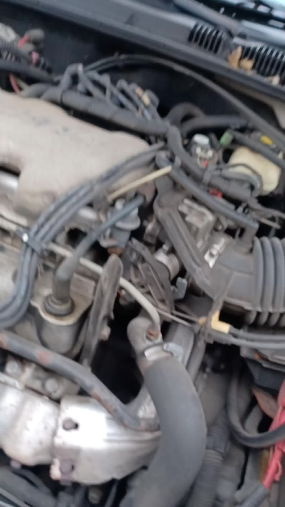

How about this one, it makes the noise at 4seconds, 14sec, 22sec, 36sec, 44sec, 53sec, 1:01 minutes, 1:04m, 1:18m, 1:32m, 1:45m, and 2:06m. It's not a belt or pulley.

Is it the single clang I am hearing? Does this only happen when the engine is turned off and still warm? Does it do it when the engine is cold?

Yep, that's it! Only when turned off and hot. Never cold.

You are hearing the exhaust cooling off. When they are hot, they expand. When cooling, they slowly contract and make that kind of noise.
Based on what I'm hearing, that is what I believe you hear and there is no reason for concern.
