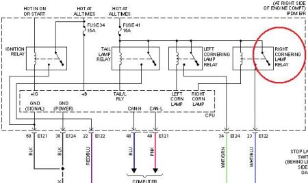

Please need help, directionals stopped working on right side of car, checked fues, and bulb both good, at a dead end can you help. Thanks

Check the relay. Under the hood, inside the power distribution module.
