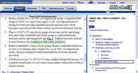

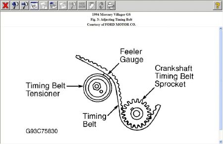

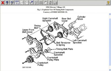

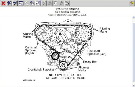

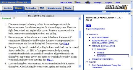

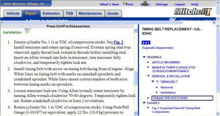

How to set the timing belt
Sunday, October 26th, 2008 AT 4:42 PM
MECHANIC
75,992 POSTS
Hi mrjunkman and welcome to 2carpros
See below
