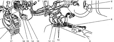

I’ve no clue where the PCM 104 pin connector is in order to disconnect it. Would welcome any direction finding it. I would really like to test that circuit fully to be sure nothing is shorted.

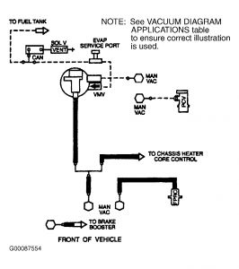

I checked yet again for vacuum leaks as I did find an area giving me a slight increase in idle when sprayed with carb cleaner. I wanted to ensure 100% that nothing was cracked, open or rotted away.
I found see images below. Under the IAC the throttle body. Below that there is a tube that runs down and it's open on the other end. It isn't connected to anything? When I sprayed carb cleaner on it the idle jumps when I closed the tube the idle drops then starts to come back up again very slowly?
Should this tube be connected to something or is it some kind of drainage tube?
The image was taken from the area highlighted by the red arrow, below the throttle body leaning over the battery on the right side of the vehicle.

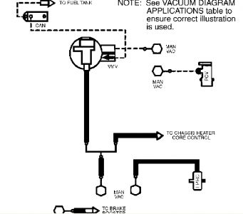

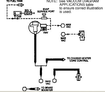

PCM 104 pin connector is at the center of the dash number 9 and I'm not sure about the vac line, but it should NOT be a dead end. There should be a decal with the vac routing on it, but heres one anyway...Any increase in engine speed means a vacuum leak and ALL must be repaired! The PCM cannot control mixture when unmetered air is entering the engine! Fix these and you will more than likly fix the problem.
https://www.2carpros.com/forum/automotive_pictures/62217_PCM_5.jpg
https://www.2carpros.com/forum/automotive_pictures/62217_vac_2.jpg
https://www.2carpros.com/forum/automotive_pictures/62217_vacb_1.jpg
https://www.2carpros.com/forum/automotive_pictures/62217_vaca_1.jpg
There are two different routings shown so here is both.

Thanks again for the response! I think it may well be that vacuum line running out of the throttle body. I found the other end of the line and from what I've been told is connected back to the purge valve? I assume that the black item in the image below? The line looks like it's rotted away over time it's falling apart.
I got a new line and once I have some daylight tomorrow I'll install it and see if that helps. Any advice on installing it would be welcome. I'm not seeing any clamps holding it on I assume it's stuck somehow. The original line looks like it was stuck to the plastic line that runs from the purge valve (black item) in the image below.
