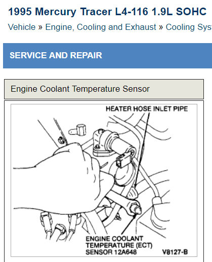

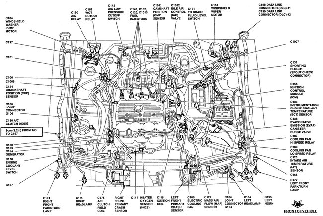

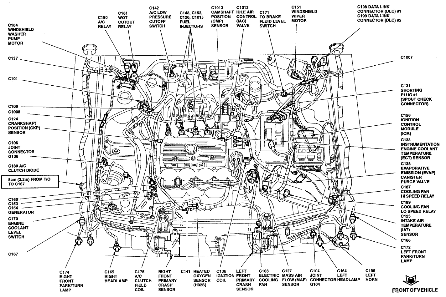

Engine Cooling problem 4 cyl Front Wheel Drive Automatic 184996 miles
Where is the cooling fan sensor switch located?
Saturday, April 3rd, 2010 AT 3:17 PM
KEN L
MASTER CERTIFIED MECHANIC
55,281 POSTS
Hello
The coolant sensor is located on the cylinder head here a guide that will show you what you are in for when changing the coolant sensor out.
https://www.2carpros.com/articles/coolant-temperature-sensor-cts-replacement
Here is the location for your car
