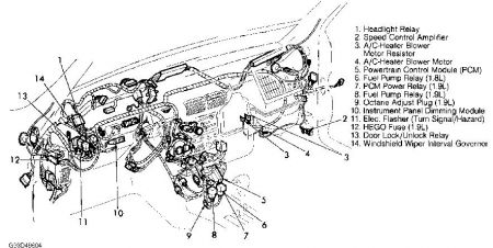

1993 Mercury Tracer not getting fuel and cant hear the fuel

are there fuses thet run the fuel pump if so where are they

Inspect the fuel pump relay. Location is forward of the center console, next to PCM (pictured below).
https://images.2carpros.com/forum/automotive_pictures/261618_Noname_203.jpg
For information on checking relays, follow the link below. https://www.2carpros.com/how_to/how_do_i_check_a_relay.htm Post results and I will follow up. Thanks for using 2CarPros.com!
