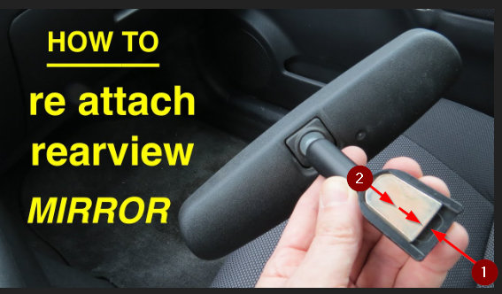

Sure. The button on this module is held in by a clip.
Basically, you are going to slide a pocket screwdriver under the button where it is shown in the picture below marked by number 1.
Then you are going to push/slide the button down out of the clip.

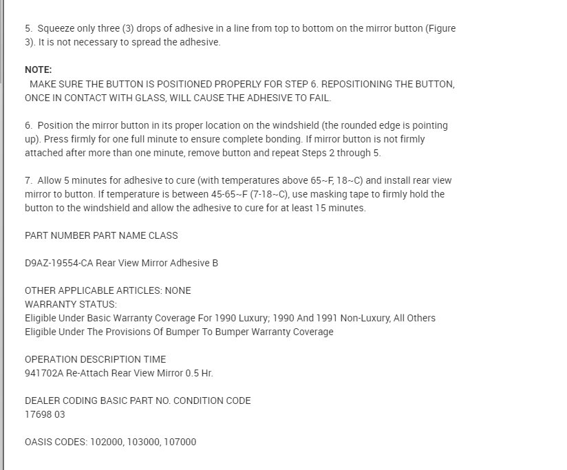

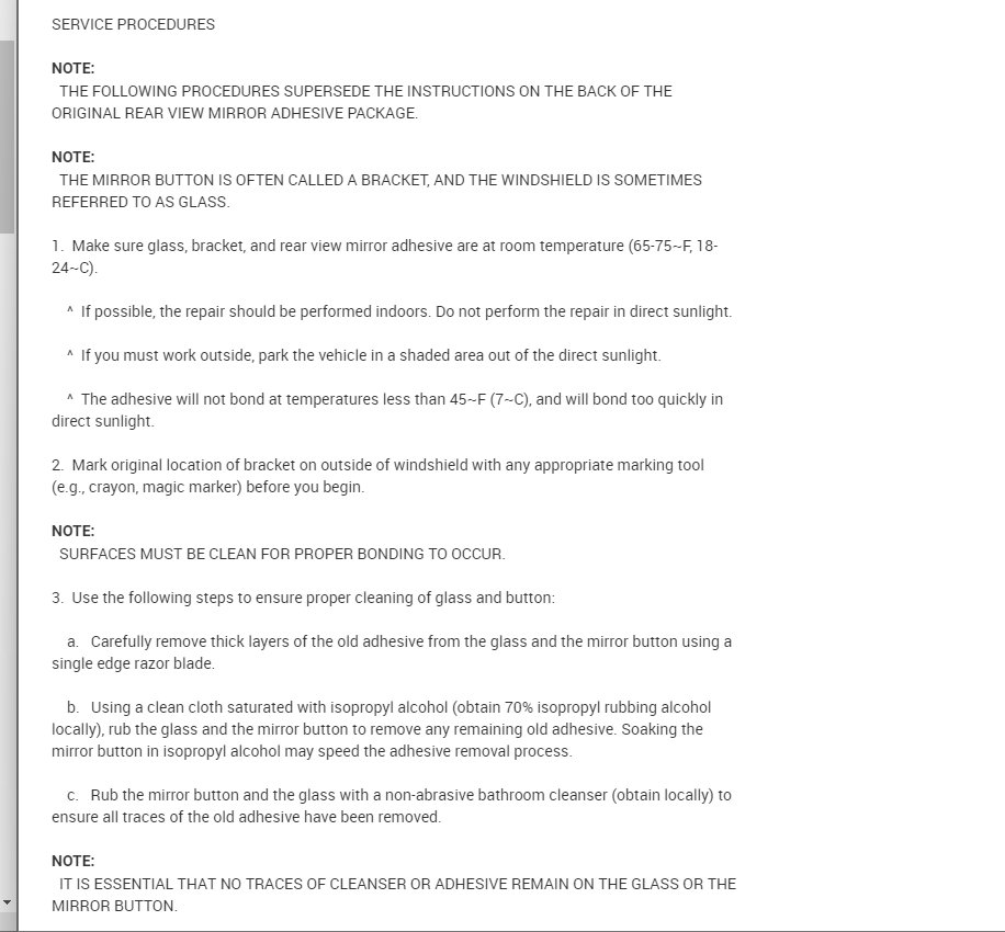

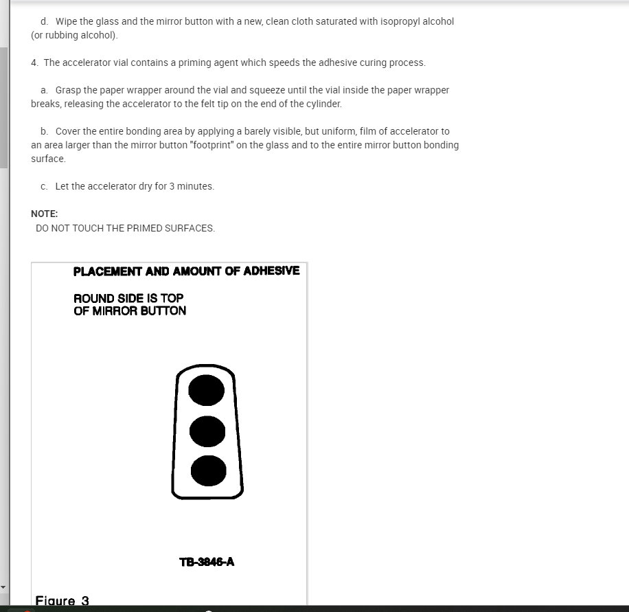

I then attached the process from Ford on how to reattach the mirror so that it doesn't fall off again.
Please run through this and let us know what questions you have.
