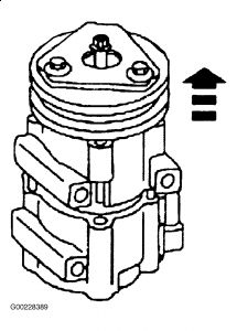

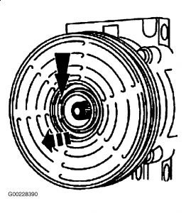

What would cause my 2002 Mercury Sable to make a loud noise sounds like it is coming from around the pulley system and the air stopped working. It cuts on and blows but does not blow cold air. Both happened at the same time. Bought a charger kit for air and the reader said it did not need to be charged?

Check AC compressor and clutch assembly. Here is a guide to help you change it out.

Does an automatic have a clutch assembly? Would that and the compressor cause the noise as well as the air problems?

AC compressor has a clutch and bearing where the belt sit check that

Thanks so much! Will the clutch and bearings going bad make the engine light come on as well?

Need to check for DTC
it may be some thing else
that giving you check engine light
codes can help identifying the troubled area
good luck
