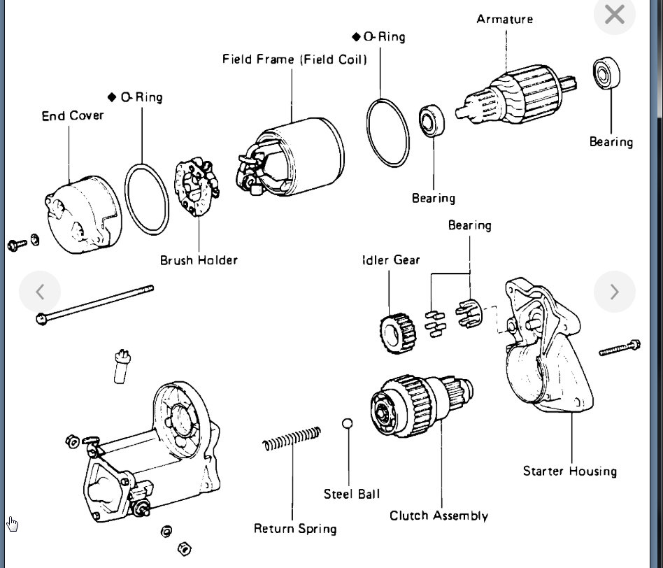

I think what you are referring to is the clutch assembly? A lot of times salvage yards take motors apart and sell them without the gear that actually engages the flex-plate to start the vehicle. Basically they expect you to swap that over from the old unit.
Let us know if this is the case or if you need more assistance and we can dig deeper. Thanks
